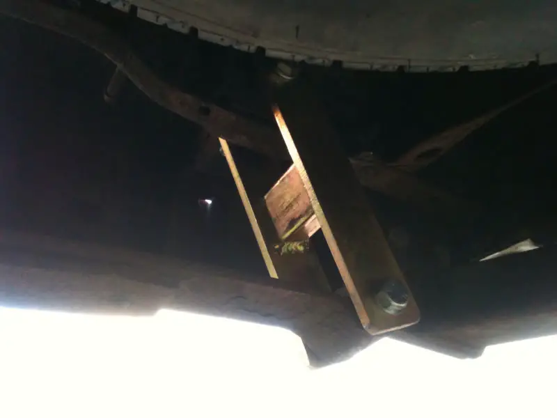

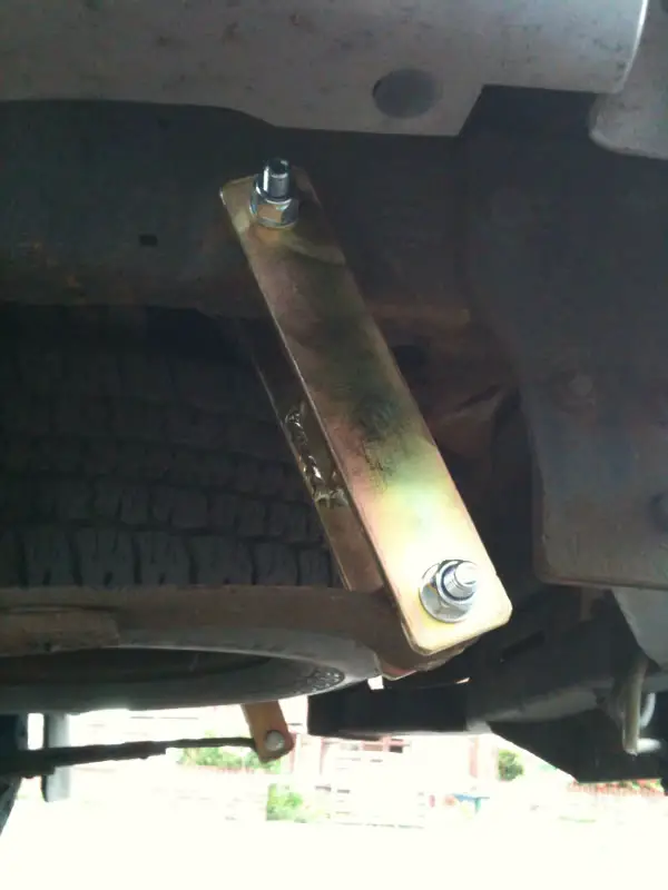

Hiya all, just thought I would show some pics of my home made rear shackles, had the dimensions from the threads on this site (really usefull) then got the plates laser cut, welded them up myself then took them for electroplating, fitted today ( again following instruction from this site) and with a little effort I think the result is more than satisfactory and I think the finish makes them luck a little less ugly than some I've seen, jim
Those look good you should do a write up for other people what metal thickness i used half inch on mine
Loads of write ups on here already and full of really usefull info and pics otherwise I would of , a quick search of rear shackles brings up all info needed and the post with a drawing showing all necessary measurements to make these shackles, jim
what did the whole thing cost you...??? money and time wise...???
wondering if its even WORTH THE "EFFORT".
I actually have the warriors, and plan to cut them down almost 3in.
when I do my SOA, so I will have some beefy looking (stock height)
shackles on mine haha
they look good though, what did you do with the front...???
:salute:
Hiya, these bad boys cost £40 gbp for laser cut steel and £10 gbp for electroplating, welding was just my time, from point of ordering steel to fitting on the truck, roughly 4 days in total ( with work commitments actually about a week in real time). The front has TT with just shy of 2" of lift , haven't measured difference on the rear yet though, but she's sitting nice and level now, jim

On mine i used half inch metal with no middle section tho havnt got to test them yet
They look good I'm just not a fan of the electroplating
