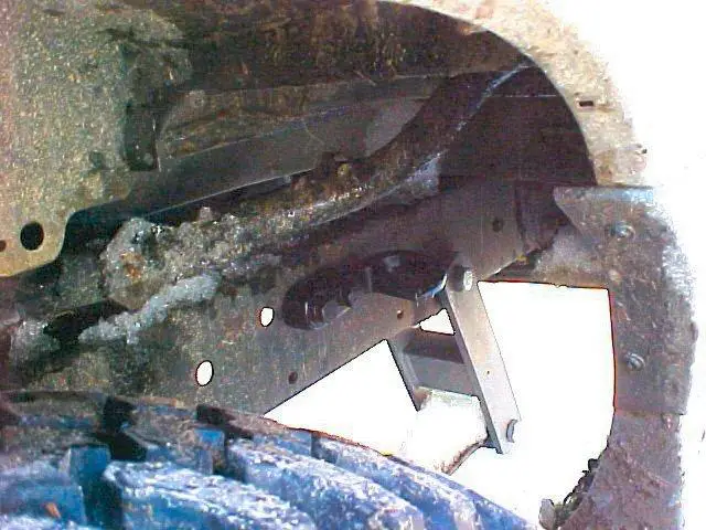

This is where I originally mounted mine, but I then moved them to behind the shackle and infront of the bumper, angled down just a little... I took them off when I installed my hitch, so I don't have a pick with them behind the shackle...
