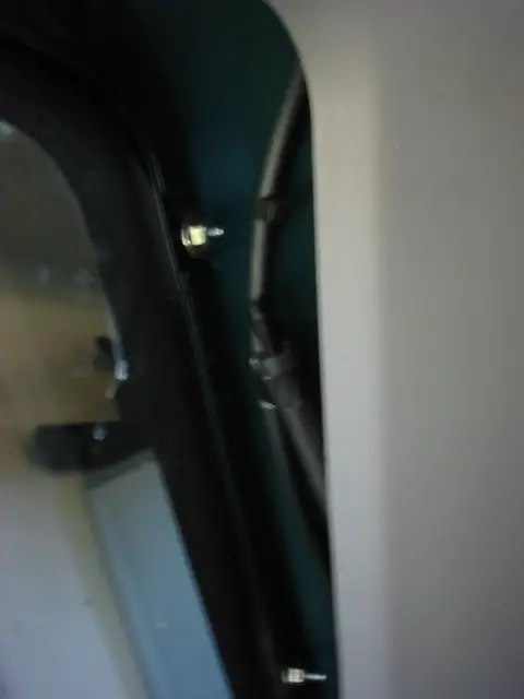

Once you've got enough of the panel off, you should see this:
(Sorry the picture's blurry, it was hard to hold the camera and the panel back at the same time.) There is a black hose that leads into the roof of the vehicle, which is how it gets to the liftgate and to the wiper. There is also another hose that comes out alongside it and just ends, with a black nozzle on the end. At first glance, it appears that there's nothing to stop the washer fluid from just squirting out this nozzle behind the trim panel.
After searching around here, I did find a post that clued me in to a red cap that goes on the end of this tube. After about 15 minutes of looking around behind the panel, I actually was able to find the cap. Fitted it back to the end of the nozzle and tested it. With the wiper working, no trouble at all.
You should now have this:
