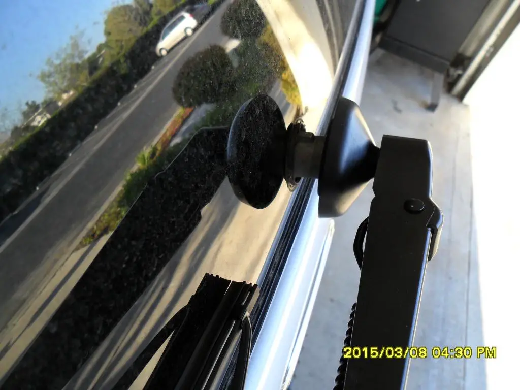

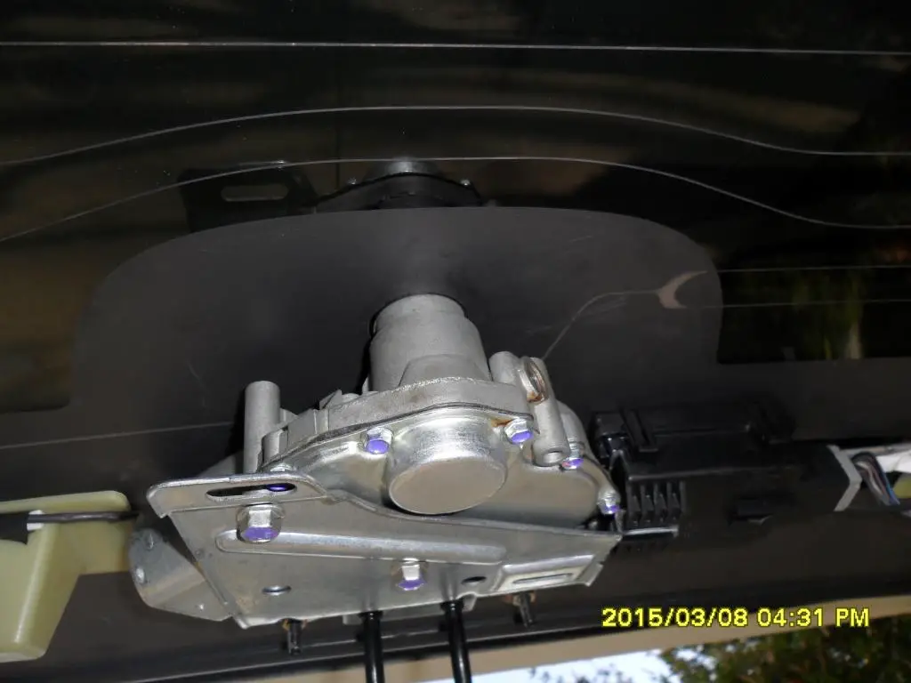

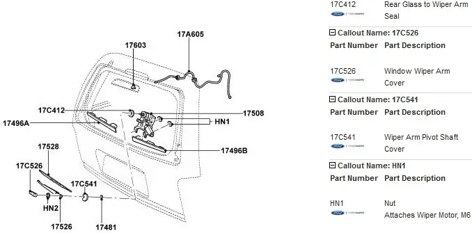

What am I doing wrong here? It seems there's a big gap (over 1") that shouldn't be there on the outside of the glass, such that the seal (and cover) arent touching the window at all. I bought the motor, arm, and wiper from autoparts store, all the other hardware from ford dealer.
I'm wondering if something here isn't right...

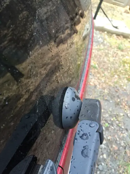

Mine sticks out from the glass about 1/8".

I now believe the seal doesn't go outside the window like I was trying before, but instead the lip of the seal must fit into the hole in the glass from the inside... somehow... then I put the motor it. But the seal seems to big to fit into the hole... I tried some syl-glide (rubber safe lubricant) but just seems the hole in the glass is too small. But I can't figure out any other way that this could work.
Second, it seems like to me maybe it's not just two regular nuts that hold the motor to the car. That mounting hardware is no longer available from Ford so I just used washers/nuts I had already, but parts diagram just calls it a nut so it doesn't sound special. But seems to me maybe there's supposed to be some type of spacer (like a rubber cork with a hole thru it or something). Cuz if I do get that seal into the glass from the inside, the angle the shaft coming thru the window will be wrong...
Spend $2 for a half day at a local wrecking yard. Pull one apart, maybe your missing a "non serviceable" part.
Y'know, I thought the same thing, went there last week and was unsuccesful. The three explorers they had where I went already had the hatches gone. (I did get some other unrelated trim pieces I wanted...)

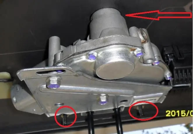

I think the seal (17C412) must go where I drew the arrow, instead of the motor itself just sticking thru the hole. With that seal in there, the motor shaft won't stick out as far on the outside. But as I said, I can't get the lip of the seal into the glass, and I can't get the motor to mount and stay in place if I put the seal on the shaft first.
And those nuts I circled, on a really long piece of thread (that already has some really flat nuts holding the latch in place) are where the motor mounts to body, and that's where I think they must need a spacer under the nut... another thing that supports this idea for me, why would they put sooooo much thread, takes forever to put the nut on like that...

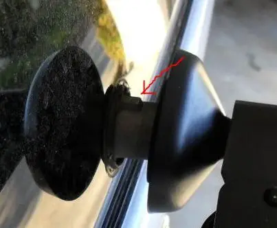

Well I finally figured it out today. The hole in the glass is too big. I'm guessing a previous owner replaced the glass (I found broken pieces when I removed the color) and the replacement wasn't OEM or something.
The motor shaft has this little notch(arrow in picture) that I think is NOT supposed to go thru the hole in glass... so I put a thing plastic washer on the inside to keep the motor shaft notch from going thru. Now all fits perfect.

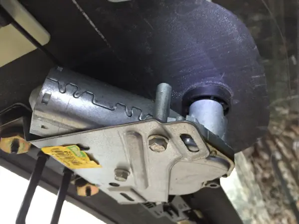

Happened to have this panel off on my '04 the other day. This thread came to mind. The OP's unit is missing a black bushing where the motor goes through the glass. I'm sure it acts a an insulator, but it also sets the motor back farther in the car.
