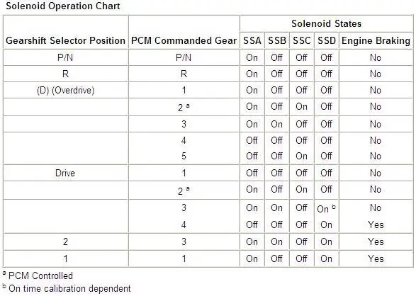

Anyway, I installed new clutches, front band, o rings and seals. Got it back together and there is no movement if you have it in drive. If you put it into 2nd or 1st, it engages. Also, you can then put it into drive, and it stays engaged. Reverse works well too. However, it will not shift out of 1st until you completely let off the throttle for about 3 seconds. Then it seems to skip 2nd and goes to 3rd. 4th works but there is no 5th. It seems that the overdrive is not engaging and that's why 2nd and 5th are missing. I did adjust the bands according to specs. I guess when I get back home, I'll check the front band and EPC pressure.
But what I don't understand is why at first nothing happens when in D until you go to 2/1 and then back to D? Oh and if I get 2nd selected, it still is getting going in 1st. My understanding is that when you select 2nd, you're actually will be in 3rd?
