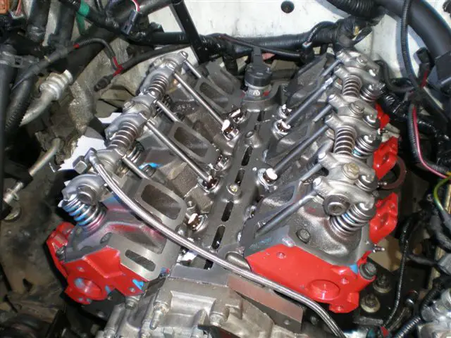

Look at this picture...
If the engine is under warranty then I would have them repair it even though it is a major pita to trailer it back to the shop...But I was looking at the build I did on my Explorer this spring and I think #5 intake would clear the head...
Isn't the valve arrangement IE-IE-IE on the drivers side which is where #5 is? It would still mean pulling the intake, rockers, pushrods and finally the dead lifter but it would be easier than all of that plus yanking the head too...
Either way it sucks to have to go back into an engine to fix a failed component...Good luck to you man...
