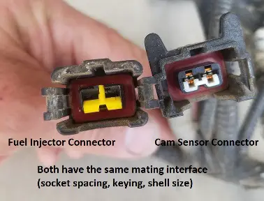

TL -- Spent a week troubleshooting and found 2 wire connectors (FI and cam sensor) swapped that were near each other and keyed the same (apparently to maximize the chance of mismating!). Check those 2!!

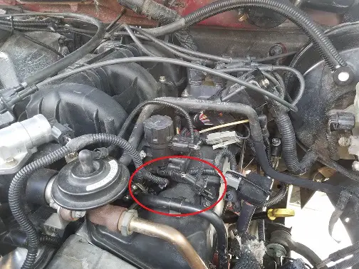

But, I noticed the cam sensor right next to the FI, so back probed that for grins and giggles. It was getting 12V. I couldn't remember if it was supposed to get 12V, but noticed that the wire colors were similar to 5 of the 6 FI connectors. Then it hit me, could they have been swapped? Yes, they connected either way! I had been installing the 2 connectors swapped the whole time since I installed the engine. They look different on the outside, but the pin spacing and keying is the same, so they just go right on when switched. The ECM wasn't seeing the cam pulses, and cylinder 4 wasn't getting any gas.

Here are some pics I took of the engine and the conns from the extra harness to show the difference:
