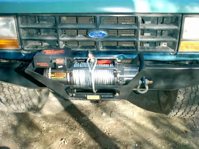

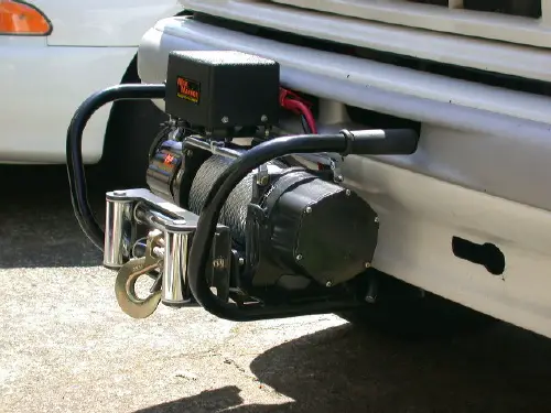

Yeah I built my own winch cradle. Used 2"x2"x1/4" tube, 1/4" plate and then 2"x1/8" and some 1" steel conduit for the handles. The 2x2 tube runs the entire length but I sunk the mounting plate into the receiver tube about 1/2 way.

My Mile Marker winch came with a solenoid and a switch panel for under the dash. Switch off, no power front or rear, switch on power to both ends. You could use 2 solenoids/switches if you want but THAT would be overkill.
The connectors live behind the bumper.
Comes in handy when you can't turn around on the trail:thumbsup:

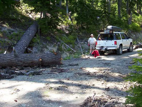

I let myself down a 200ft 60deg VERY loose gravel slope no problem and I still have a stock alternator.
One thing to note, that winch and the carrier are HEAVY (about 100lbs) you might conside synthetic winch rope. That'll trim about 30lbs.
As you can see from the pics we lowered most of us by winch and DiffWhackDaddy took a different path that required more ground clearance than we had. There was no body damage of any kind to anyone on that trip and we had a stock G-II with us.
