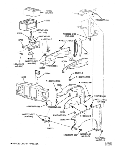

remove left and right fender
there should be 3 or 4 bolts that hold it to the top, you'll see them when you open the hood (there right where the hood and top of the fender meet) one towards the top in the side when you open the door and 1 or 2 at the bottom by the pinch weld. you may also have to remove some wheel well guard screws. sorry as its been a while since i had one off, hope this helps
95 Ford explorer sport
How do I get the bolt by the bumper off that goes into the fender
You probably have to remove the bumper first; it's been years since I had to take mine off. Good luck.
