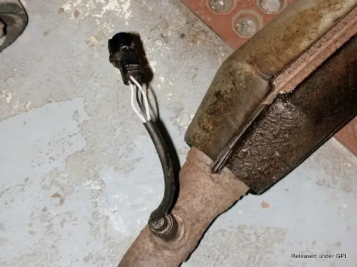

Brooklyn Bay suggested that while I have my exhaust line pulled for a tranny rebuild, I should check out my O2 sensor to see how it's doing.
Boy, am I glad I did THAT! Everything went swell, thanks to Brooklyn suggesting I use a torch to heat the pipe by the sensor so it would come out easier. This sensor is SERIOUSLY jacked-up.....
Here's the beast. It's a three-wire Lambda Sensor; which I believe would mean it is heated, yes?

Heating the pipe....
Checking the temp....800 to 900 degrees seems to be sufficient.
Out it comes!
Now for damage assessment.......
As you can see, the plated Zirconium is not plated much anymore....What do you all think?
I'm trying to figure out for sure just how old this thing is....Anyone see anything in the part number to give a clue?

Anyway, I think this sensor is shot, folks. Anyone think not? Abby definitely seems to think it's shot, AND she objects generally to the smell of it.
Anybody got a good used one on the cheap?
