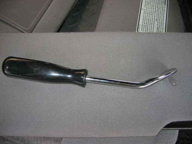

I would pick up a trim removal tool like the one pictured below (under $5 at AutoZone). The shape of the tool allows it to evenly support the push pins and remove them without breakage... I would highly recommend getting one.. Also the coat hanger bolt (step #5) is a 1/4" drive 5.5mm socket.
yeah that tool is very handy :D. Ive used it for other things too. 5.5mm ill remember that for next time i dig into it.
