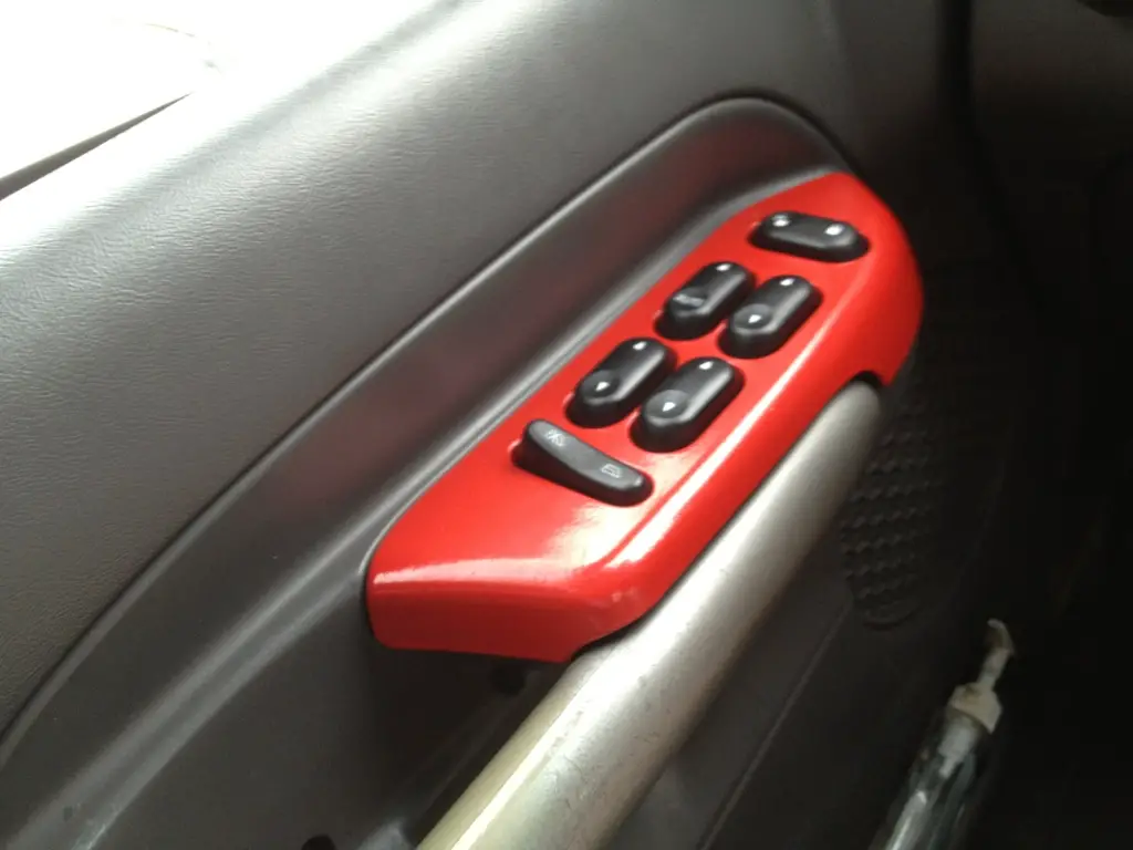

Sure have! Krylon fusion spray paint. Lots of thin coats and it will hold up to anything. Mine's a trail rig and gets dirt and mud all over all the time and hold up well to cleaners. No prep other than cleaning the parts before painting. They still look like this over 2 years later.

I used duplicolor hyper silver wheel paint for mine. It matches my wheels and holds up well!
looks good. Did you remove the door pulls to paint them?
Yes, I took them off and scuffed them up with scotch brite, then sprayed them with Bulldog adhesion promoter, then primer, then base and clear. They looked horrible when I got them from the junkyard!
Yeah, mine have almost no paint at all on them anymore. I wish I'd painted them while I had all 4 door interior panels off, but it wasn't a priority then. Oh well, not that hard to take them off again.
