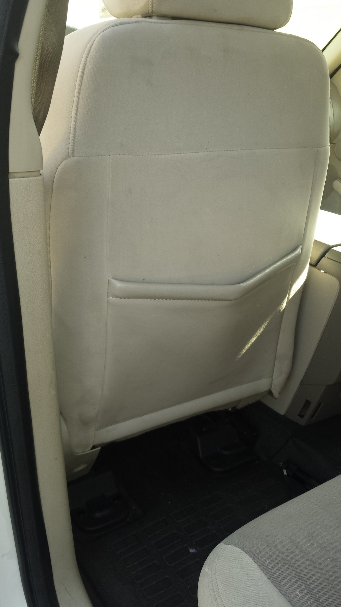

The Explorer and Sport Trac do not have the same plastic back that some trucks and cars do. So you do have to lift up the upholstery.....

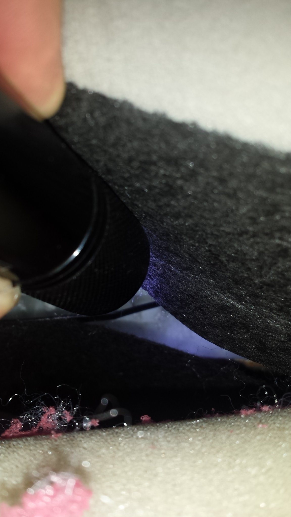

On my 07 Sport Trac manual lumbar broke and didn't want to unplug the seat due to the air bag and didn't want to pull up the seat cover so only choice was to cut a hole in the seat back. Bought some fiber fill at Michael's and stuffed it in front of the lumbar plastic. After looking at it realized the plastic came off at the left side. There is a hole in the metal frame on the left so zip tied the plastic to the metal and it works. Going to leave the fiber fill in for awhile. I like a lot of lumbar support and it may soften the impact and prevent it from breaking again. Will sew it back up after I drive around awhile. Use latex gloves there are some sharp parts in there that will cut your hands like a razor. If you just want to zip tie it you could make a small cut on the left side big enough to get your hand in there and install the zip tie
