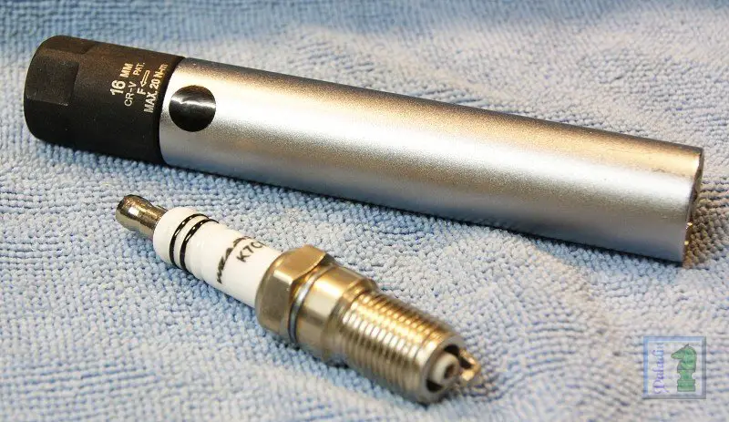

Where can we purchase the 4.6 socket? O'Reilly doesn't sell them, haven't been to Autozone yet. Dealer item maybe? Be handy for changing the plugs in the Mustang also.
Thanks
parts store sell them, long sockets, they are cheap less you buy something like snap on, which is over 50 bucks, in parts store under 20.

if you use the 4.6l spark plug socket, you can get to the whole pass side with out a problem from under the hood.
I can't find this anywhere. I want to change the plugs on my girl's 2001 ST, and they are a PITA to reach. If this makes it easier, I'll happily buy one, but I can't seem to find it.

Will this socket work just as good?
http://www.toolpan.com/OTC-Tools-69...SD0tKg8ThPNtin2dgpkoAeJz--yT3wFSWgaAman8P8HAQ
If not, what auto stores will have the one you showed in the picture? Or is there a link to purchase it online or from Amazon?
