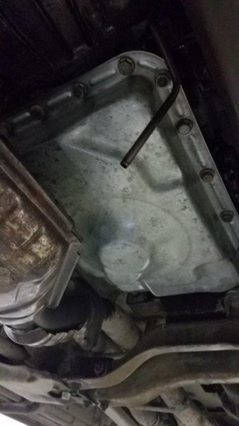

Is the tube in the picture below an overflow for the transmission?

Yes that's the vent tube, not really called a overflow but will leak fluid from here if overfilled.
