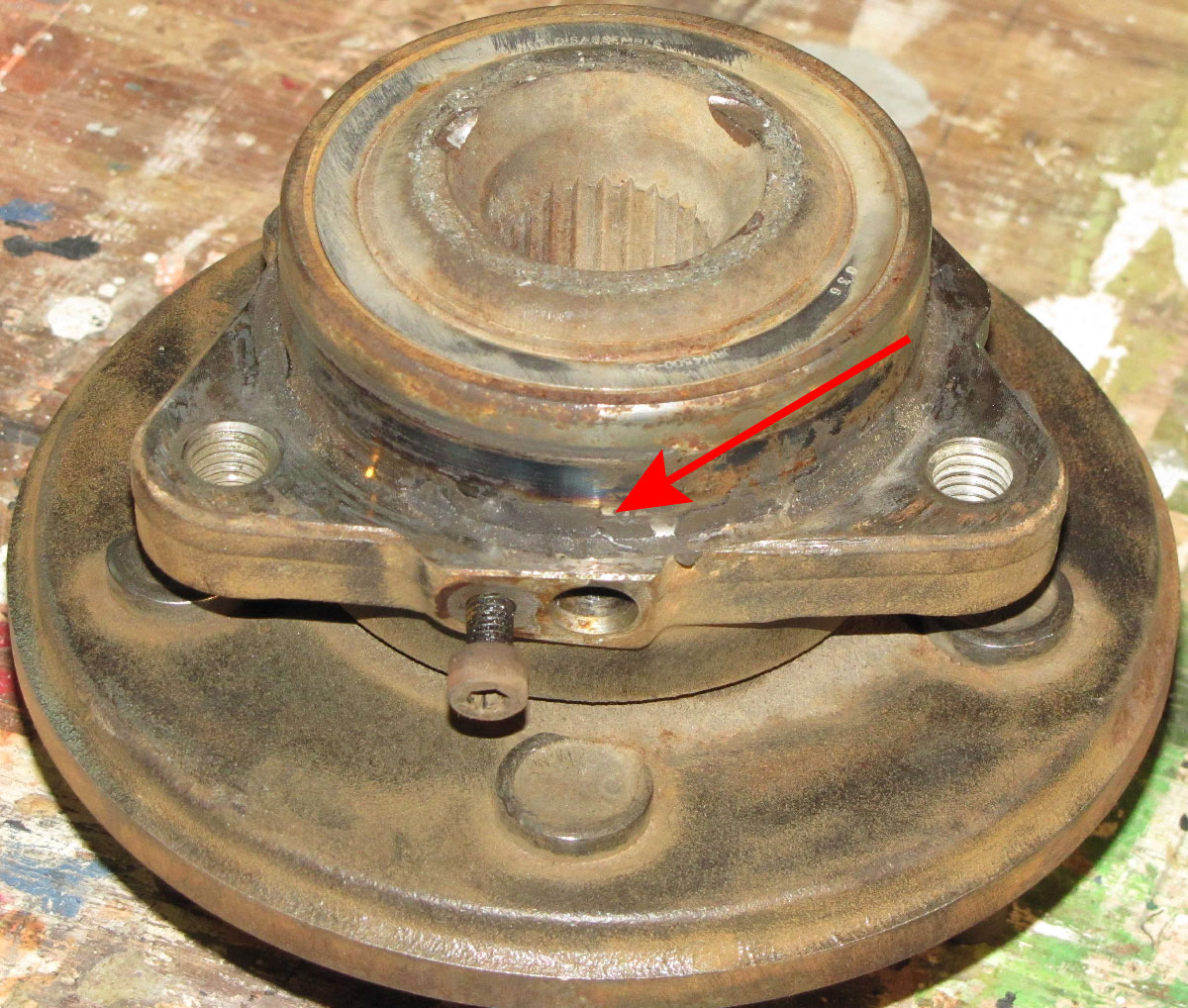

I don't believe that this is the seal I was asking about. The seal that I am seeing on my old part is not between the hub and CV joint but about an inch further out between the hub and the knuckle. Here is a picture,
The red arrow is pointing to the remnants of a rubber seal or gasket of some kind. This is where the hub/bearing assembly inserts into the knuckle. The CV joint would sit on top of the hub as pictured. The remnants of the rubber seal pictured above is the part I am trying to replace. For this location, sandwiched between the hub and knuckle, I do believe that a bead of RTV silicone would be acceptable replacement if it is required.
