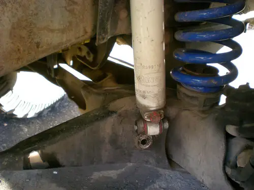

How is that I go about replacing a busted lower front shock bolt? Apparently.. it looks like it may be a stud of some sort. Is it removeable? Am up $#%^ creek without a paddle???
Any help would be greatly appreciated..

I busted on off a few weeks ago changing the original shocks. There's plenty of threads on it. But net of it, you can drill out the spot where it broke and put in a 1/2" by 3" long bolt (with washers obvisouly) and a locking nut or regular nut with loc tite.
I've broken it a couple times. The first two I put on were welded where the factory one was.
When I broke the last one I drilled out factory one and used a grinder to remove the bits of the welded on one. I then put on replacement lower shock mount (it bolts on).
So far so good.. and if I break one again I can replace it easily since it is bolted on.

Thats the basic idea but they do make lower shock mount just for what you need to do. The good ones are designed so you have something to grab onto on the shock side of the mount to hold it still while you tighten the nut on the back side.
I've seen that shock mount at a few different auto parts stores. If I remember correctly you need a better store than Autozone or Kragens (checkers).. NAPA, CarQuest etc should carry it.

I went through that & used grade 8 bolts lock nuts & washers.
Napa also makes a shock mount kit. this is a bolt on kit & is supposed to work very well. Although you have to enlarge the stock hole a bit for the new mount to fit. I have them but not installed cause the bolts I have are working fine.

I picked up a pair at lunch.. They are actually from the "Help" section. The part # is 31001. Turns out the one I got from Merles before they don't carry anymore. They only carry the ones in the "Help" section.
The one from the help section is round on the outside of the RA while the last one I got it had some cutouts so I could put a wrench on it.
The Help section mount needs a hole on the RA slightly bigger than the threaded end (the end that has the nut that holds the shock on).. My guess is 5/8" or so.

Get out to the salvage yard and find an older Ranger (pre 90). They have an additional angled bracket that wraps around the bottom of the shock. Then use a longer 1/2" bolt that goes through the entire assembly. Fixed forever... Ford had a good design initially, then, like all manufacturers, they simplified and cheapened.
I replaced mine this evening..
the ones I got form autzone (Help section) need what looks like a 9/16th inch hole in the RA..
I decided to use the bigger ones. The ones I used are for a 3/4 Ton Chevy (I think rear). They needed a 5/8" hole.
