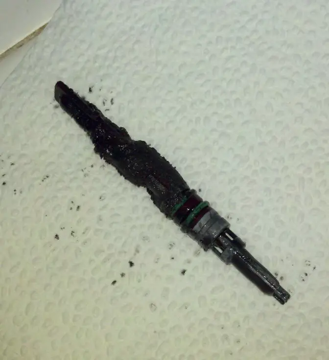

I came home and replaced the orifice filter. I pulled one out that was brand new just a few days ago and it was GUNKED up big time with crap (from all that stop leak). This is now the third orifice filter that was gunked up. I put a new one in, but there is no way to test because the system isn't charged. I have a new accumulator on order anyways that I will install before I get charged.

Here is the THIRD orifice tube I've pulled out just in the last week. The new plan is to have the system completely flushed AGAIN by another mechanic, then I will install a new accumulator and replace the air compressor again (I just put a new one in but its already failing because of all the junk). The new orifice tube shouldn't be dirty at that time because there is no freon in the sytem now, and I put a fresh tube in today.
Once I get system flushed again, the accumulator installed and the compressor replaced again, I will get the system charged again and hope this time everything works ok.
