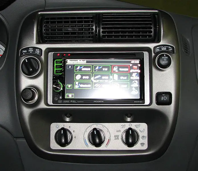

And this is as-installed in my ST. The paint, which is a 99% match to the stock dash trim color, is Dupli-Color Import Auto Spray, Dark Grey (M) CC, # E8800564, UPC 0 26916 80564 5, 5 oz. can. Pep Boys, among other suppliers, sells it. I topped it with a single coat of clear (unsanded--to keep the "gloss" low like the stock trim). Also, be sure to lightly sand the filler plate so that the paint adheres properly.
attachment.php
One other thing to consider is to line the inner lip of the dash bezel with black self-stick felt (behind the filler plate). Because no filler plate fits 100% perfectly, the black felt will block out any light from penetrating behind the filler plate and will make it appear as though it seals the opening completely.
