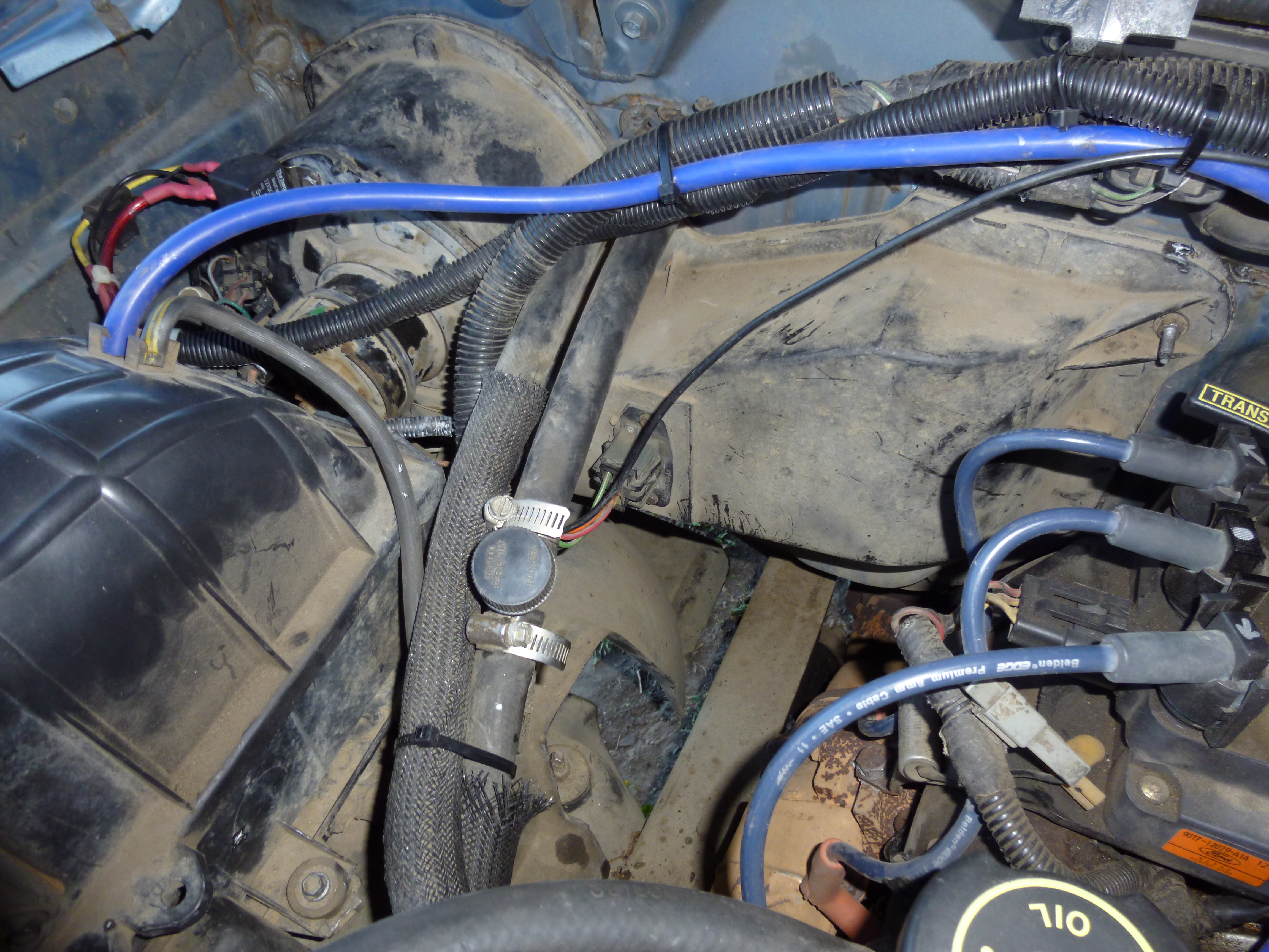

Ever since I first saw the modification being done, I wanted to do it to mine since the compressor was long ago removed. It seems my Explorer either had the AC system rebuilt or put on aftermarket at the dealer. My blower box had a WYNN sticker on it with a serial number and looked much different from the factory ones I've seen. It never had any insulation and seemed bulkier than the factory ones as well. I wanted to get rid of it since it was unbelievably cracked, melted and a waste of space.
I didn't get any pictures of the before but you can see the box in this picture:
Bulky and ugly.

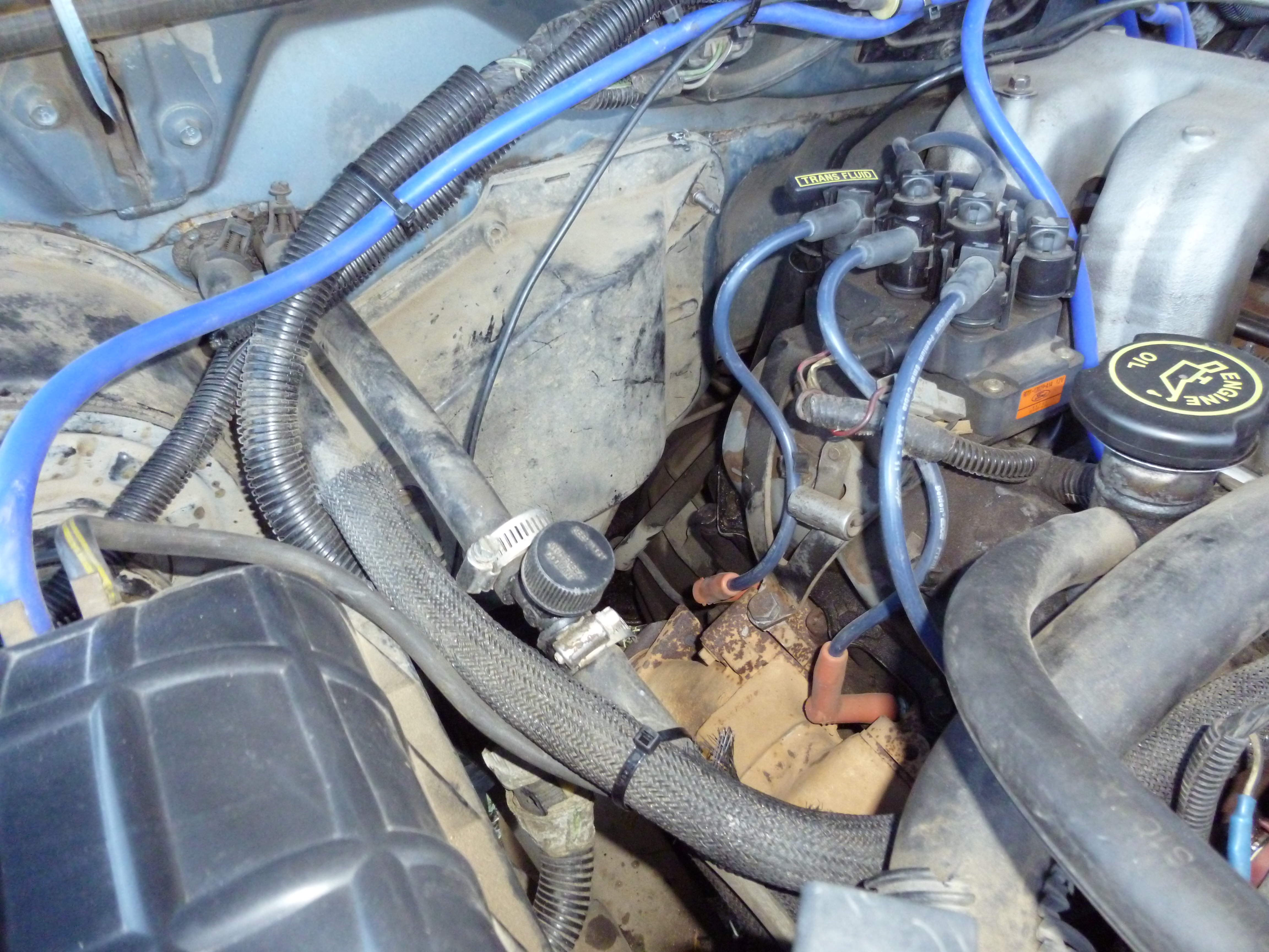

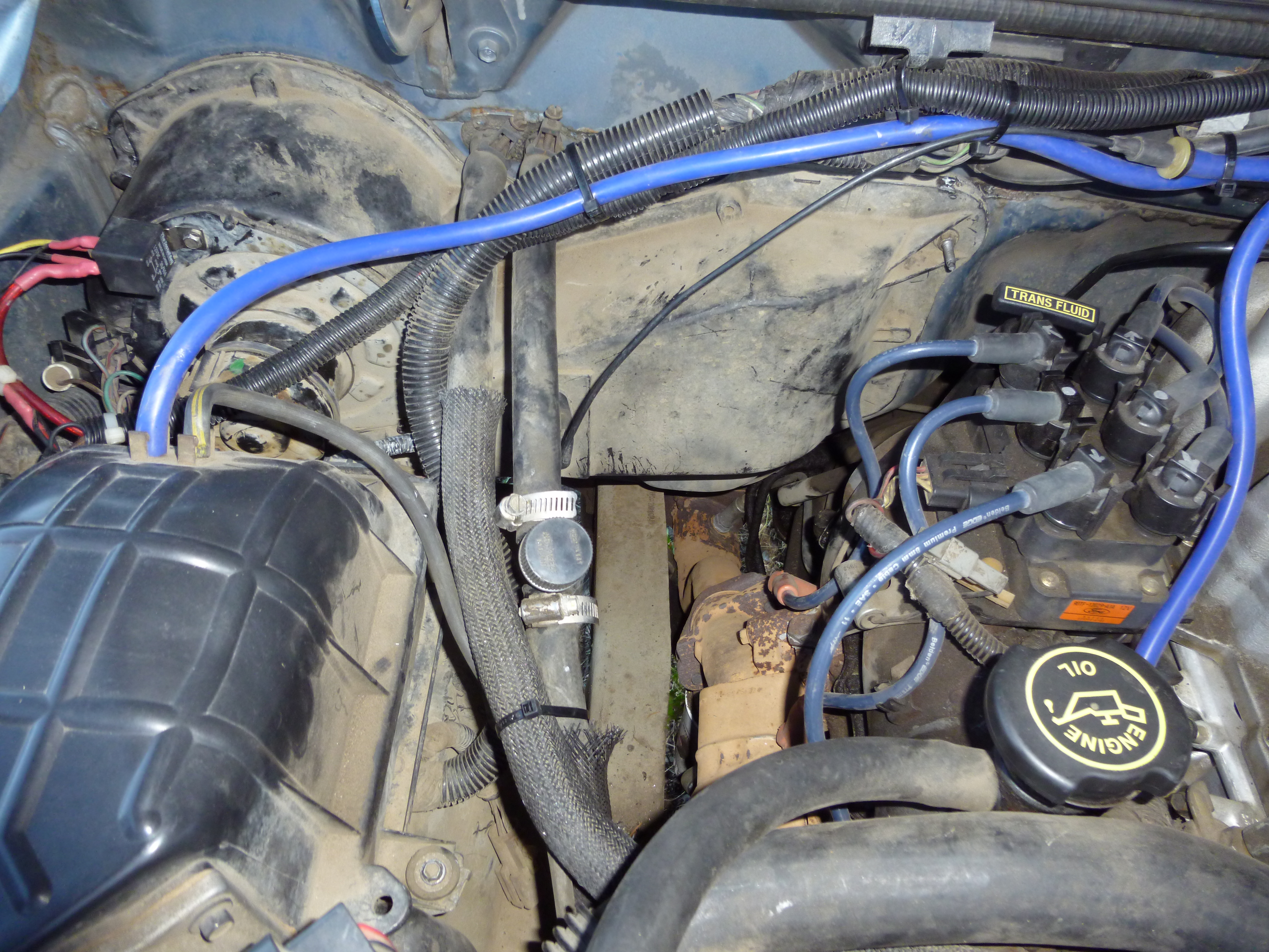

Today, I finished putting the non-AC box in. Most of the time was spent prepping bolts/screws with anti-seize and tidying things up.
I wish I got more pictures but this is the end result:
