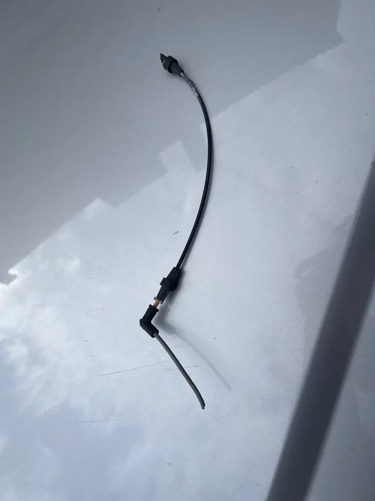

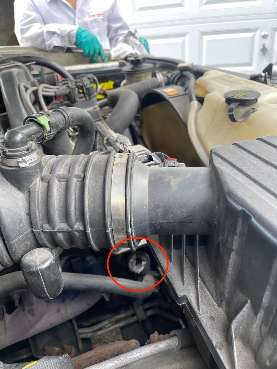

Hello Everyone,
I am hoping that one of you can help me Identify something on my vehicle
Ford Explorer 2006 XLT 6 cylinder
I was working on my car yesterday with my dad when he noticed a torn cable.
We followed the cable, and it appears that it had been glued at some point on the other end. We couldn't figure out what it was. The location where the cable was glued into is directly below the alternator. I am attaching some images of the glued end and the cable to see if anyone is familiar. I have put red circles around the location to make it easier to hopefully identify. Thank you all in advance.

That isn't a cable......it's a vacuum hose. That's the passenger side of the engine. One end of the hose connects onto the "heater control valve".......this heater control valve is the part below the alternator......the other end of this hose travels up towards a location between the fender and aluminum air conditioner system pipes. Up near the firewall on the passenger side of the engine compartment.......I'm NOT sure, but I think the hose up there is white........it eventually travels on and attaches to the "tempersture adjustment" knob on the A/C panel inside the passenger compartment.........

Note for Andres666. When purchasing a new heater control valve, make sure you bring the old one with you so you can match it up with the new part because there are three different designs for these valves.
Ahhh. OK. Since you mention adjustment knob.... the knob on occasion does make a clicking sound when I set it all the way to high heat.
