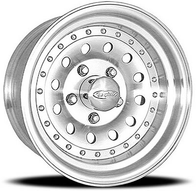

go with a 15x8 if you can...a 15x7 will work, but the 8 will look better IMO
how about the 3 3/ 4 in. Backspace
7's or 8's , what Backspace is good..
With the 8' you want the 3 3/4 bs.
ok good...
no ..hold on ..is that the 3.75 ? or the 3.25 ?
3.75" is 3 3/4" ........ 3.25" is 3 1/4" the ideal b.s. is 3.75" although when i first got 15x8's for my 31's i got 3.25" bs cuz i like a wider look and stance. i jus had to trim a tad of plastic and it fit great. u lifting it or leaving it stock? and like they said definitely get the 15x8" wheel
im going with a 2in. spring and add-a-leaf lift ..
and U.S. wheel (summit p#) usw-97-5812 , 3.75 15x8 rim , with 31x10.50 15 kumho Venture MT's
not to bad for 719.70 $ lol..
