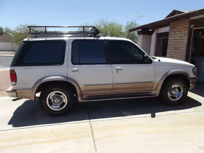

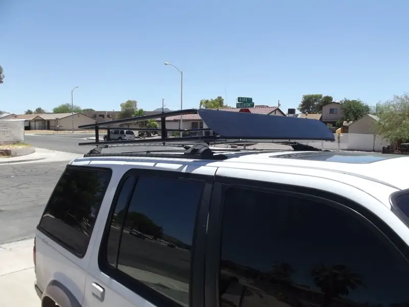

My basket has been mounted to the stock crossbars since 2015. No issues. A pic to show the height with stock crossbars.

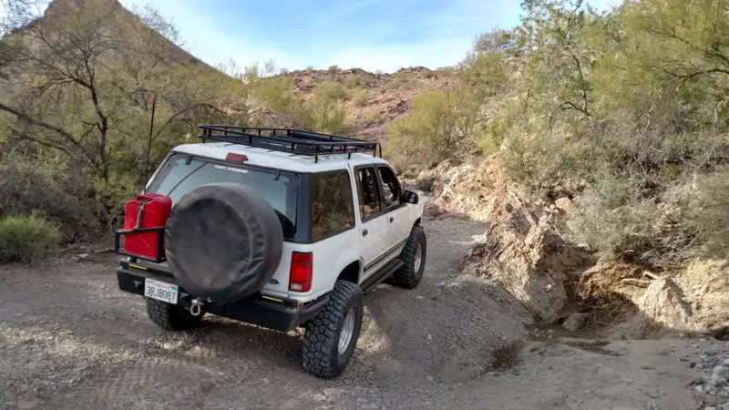

If you are looking to mount a roof basket as low as possible you could remove the cross bars from your roof rails. Then fabricate sliders that fit in the roof rails to hold your new basket. Remember the roof is not flat, its higher in the center than the sides. My rails were pulling out of the roof sheet metal after many years with a aftermarket rack. I made an entire new rack out of 3/4" EMT conduit that has worked out very well. I wanted something low profile that could carry whatever I wanted, and be just tall enough to mount a Hi-Lift jack inside the basket. The rack is bolted through the roof with "well nuts" in the channels.
