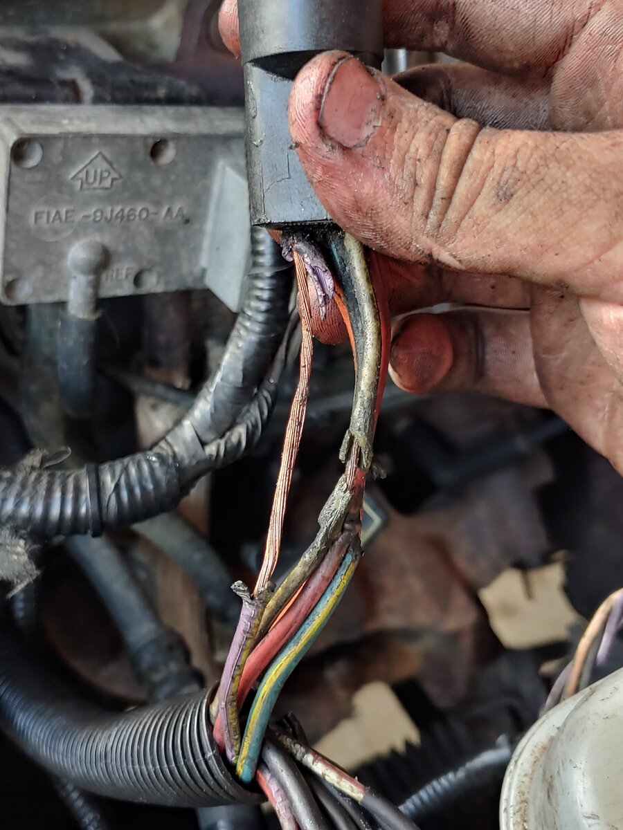

Had a similar issue along with a bunch of other issues. All of my symptoms, including that, went away when I fixed the frayed, exposed wiring harness by my charcoal canister.
What portion of the harness was damaged? Was it close to the canister? Was it chafing on the body or somewhere on the engine?
It looked chemically melted. Visually inspect all the wires that secure on the driver side wheel well. Look for exposed copper. Mine was pretty obvious once I visually inspected the harness's in the area.
View attachment 342051View attachment 342052
Wow! That thing was a mess. I took a quick look at mine today and didn't see anything, but I plan to do a better inspection in the next few days.
