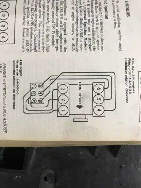

Incorrect info from manual

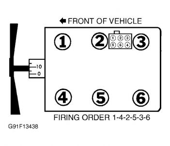

Here's the first schematic that came up when I searched online. It cranked right up!
Mystery solved!!
Turns out the Chiltons manual I was using had the firing order and spark plug orientation way off.
So it should've fired up the first time...
Well, there's $40 worth of gaskets that I didn't have to change.

Incorrect info from manual View attachment 167834 View attachment 167835
Here's the first schematic that came up when I searched online. It cranked right up!View attachment 167836 Mystery solved!!

Wow that is way off, no wonder that engine ran like crap. Glad you found the solution. :thumbsup:
I have found stuff in my Alldata files that are wrong too. It had the return signal wire being the same from the TPS, CTS and IATS and 3 different 5 volt circuits going to them, which is exactly backwards:laugh:
Never hurts to verify the data when it seems wrong.
