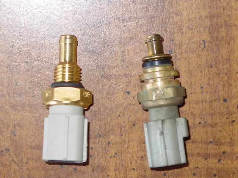

I drained the coolant and removed the old sensor and was about to put the new sensor when I noticed this:
New on the left, old on the right.
Was there a mixup at NAPA or is something else going on here?

Disconnecting the battery clears the codes temporarily until the problem is solved. The part on the left is the most common design. The one on the right isn't familiar to me. Replace the part with the new one. How much was it?

Anyways, this doesn't make sense to me, I mean it would be nice to use that new sensor but there are no threads at all in there. How am I supposed to put it in?
The old one just pushes in and there is a clip that grabs onto the ring you see in the picture a bit below the rubber piece. I did try to still put the new one in but the clip isn't made to grab onto threads so I can work the sensor out easily with my fingers.

I overlooked the fact that it was missing threads. I was looking at the odd shape of it compared to the threaded version which is more common. I mostly work on older Fords. Your vehicle is a 2003, so they might have changed the design on all of the newer ones. Have your boss try to get it for you.

Thanks for the help, I guess I'll just ask my boss tomorrow and hopefully NAPA has the one I need. Even the Haynes manual said to "unscrew" the sensor, but it also said to remove the clip...doesn't make sense to me since it would only need the clip if it didn't have threads, the one that has threads wouldn't need a clip. :confused: damn Ford
