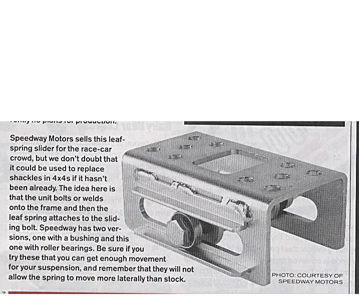

I found this in the February `03 issue of Petersen`s 4 wheel & Off-road
It`s actually nearly how I thought it might look, but if you can read the write-up, it was designed for racing cars. Found a website, but couldn`t find that slider there.
It`s interesting though, to find it. It says there will be less lateral movement than stock, you guys think that is a big deal?

Bingo!
I`m going to ask them some questions like mainly how long they are so that it wouldn`t "bottom out" when flexing. I wonder if they will say they are strong enough for off-roading?

Personally I don't think it would be worth it.
You aren't going to gain any flex by switching to it.
If anything you will lose flex because it can't twist at all.
