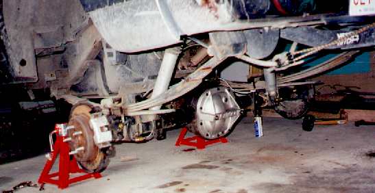

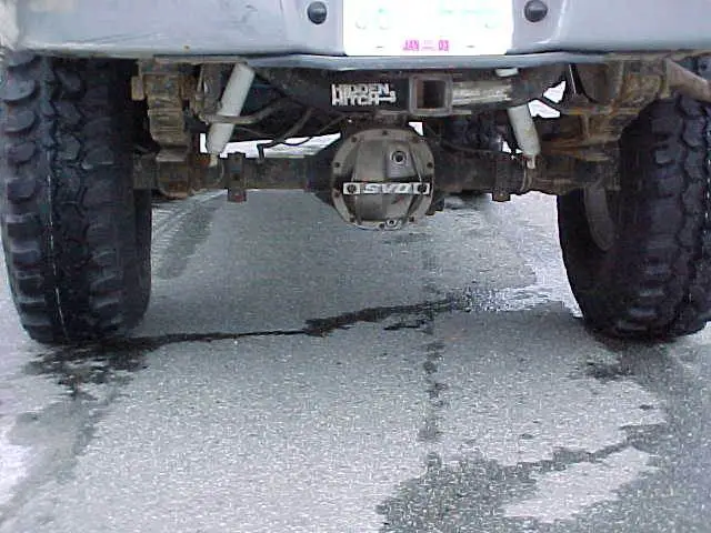

My Hidden Hitch doesn't come anywhere near my shackles. It curves up and goes up towards the frame several inches away from my shackles. The part of the hitch bracket that mounts to the cross-member is a couple of inches next to my shackles. You can see the bolt for the hitch between the shackles and the hitch support. There is nothing behind my shackles that they could hit.
Wow, your hitch is TOTALLY different than mine. I need to take a pic today. Mine looks just like Weebo's. Wow, where did you get that ? Is it actually for an Explorer, or did you "make it work"?
It was made for a '95-'97 Explorer, bought new in February '98 from some trailer store outside Toledo, OH. Remember thought hat I have a 3" body lift. The hitch receiver would normally be just under the front bumper.

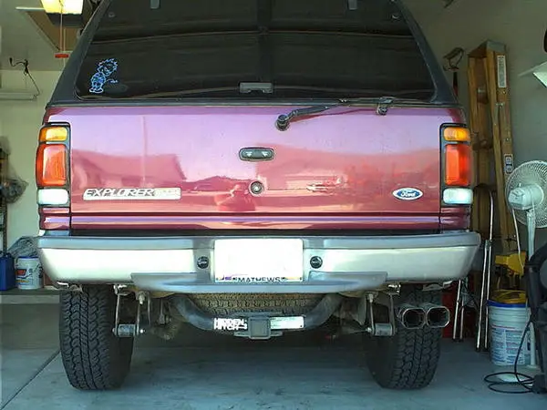

Yeah, I figured you had a BL, but the bend in it is still totally different than mine. But mine is applicable to all X's 91-01 maybe that's what it is.
Mine is just like Robert's, miles away from the shackles.

I have the same hitch as Paul, Robert and Shaun.
