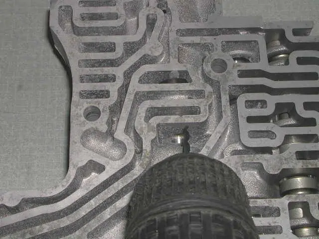

it is a piece of cake. Check out the Rebuild Diary in the useful threads forum. While this shows (in part 3) the process for drilling the A4LD, it is nearly identical in the 5R series. Go look at that before you panic and worry too much. If you can pull the valve body, you can easily drill that intergallery hole, and drill the separator plate. I encourage DIY.
Here's a pic..
thanx Glacier, ill hit that page up, maybe ill gather up enough courage to do it myself, my main fear is that hole i have to drill
