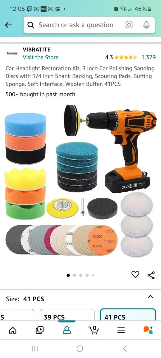

Which kit did you get? I think that Harbor Freight sells a kit for that.
This one here off amazon I have to say the price it did a damn good job!!

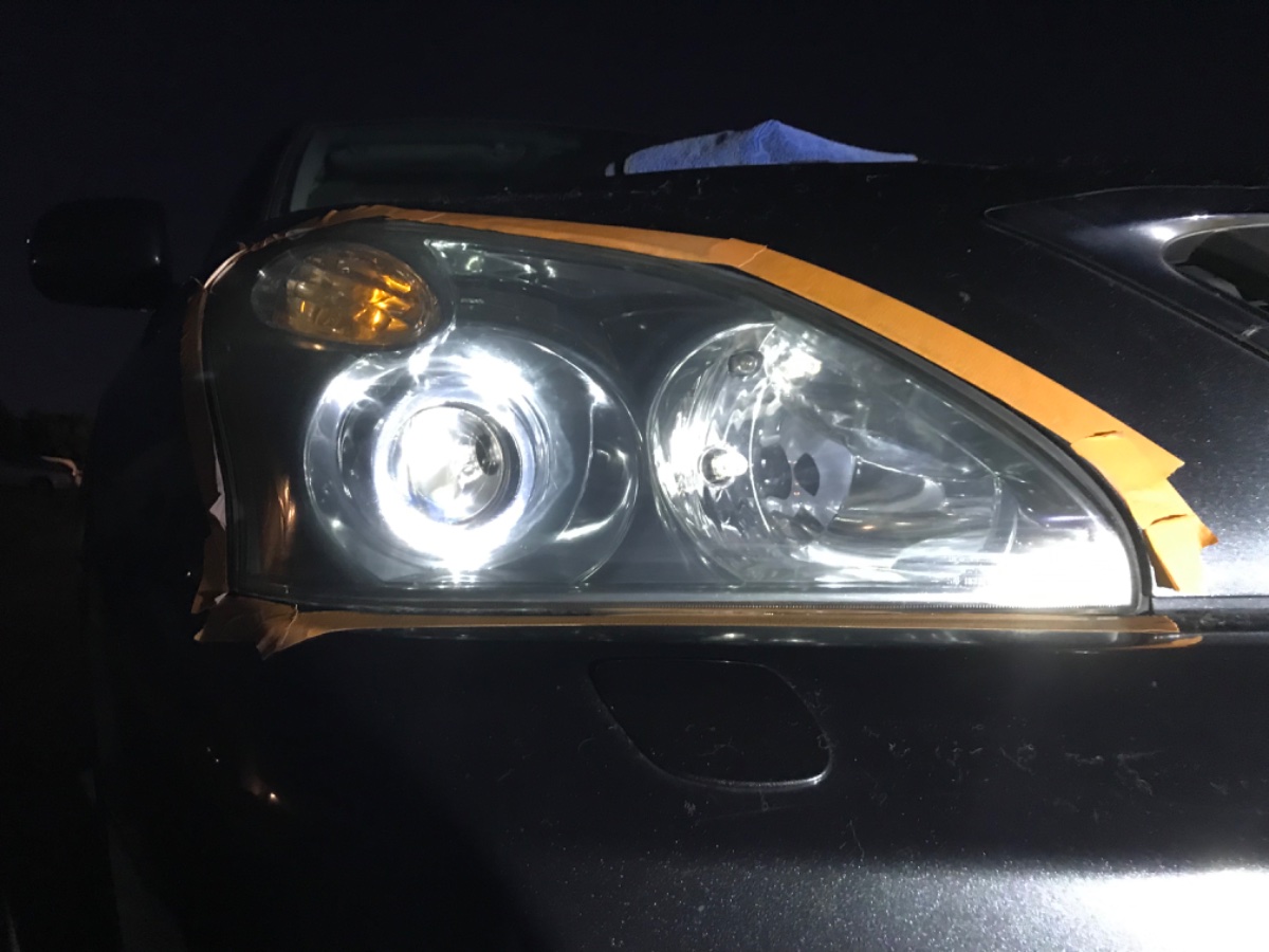

This was the most recent a Lexus RX sorry I finished it at night so the lighting isnt equal but I think you cna tell.
