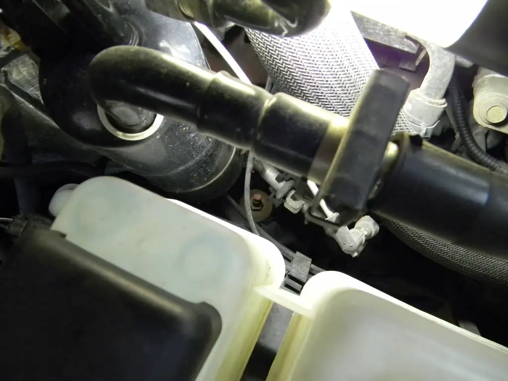

The front shocks have 15mm nuts. I popped the hood open and found the tops of the shocks, others did it from the sides, and looking back it seems alot easier haha. Here is the shocks from the engine bay.
Driver Side (Left the socket on lol, just follow it down in the pic and there it is)
Passenger Side:

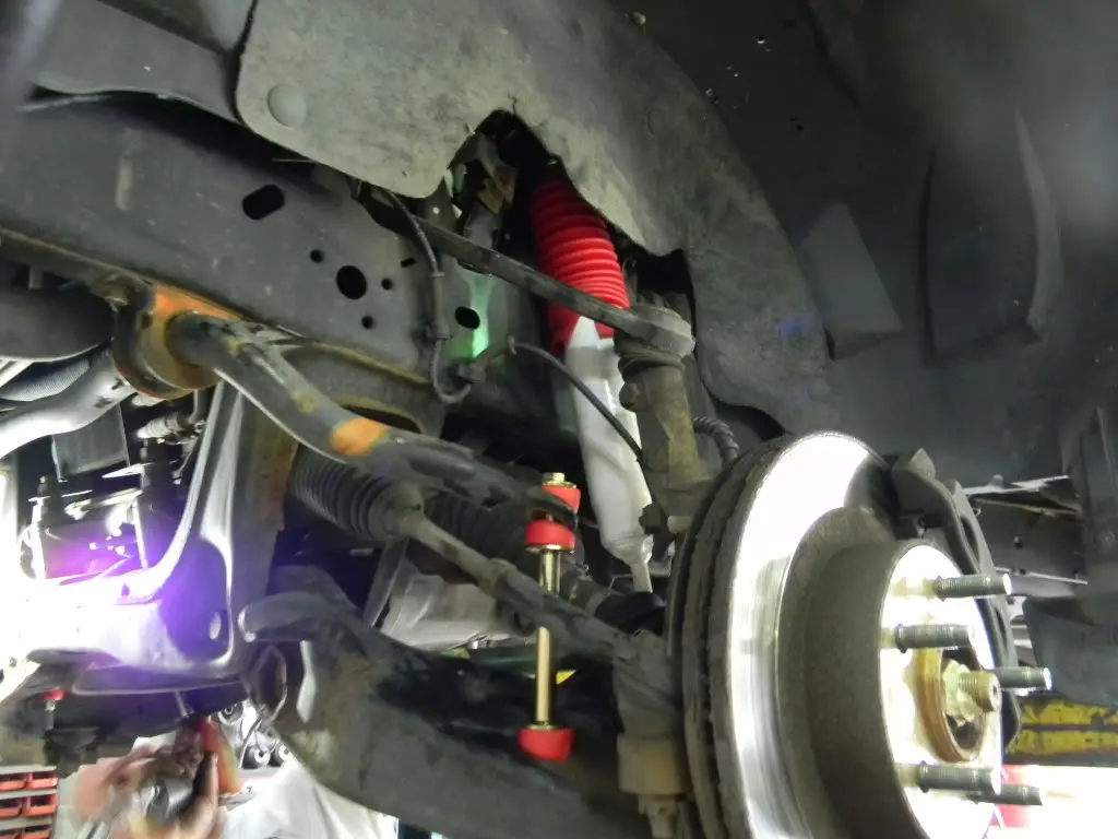

Now get on under it and find the TWO bolts holding the bottom of the shock on. I actually had to use some heat and cut these off... they were on tight but get those two off and the shock should pull right out. The process is the same for each side of the vehicle.

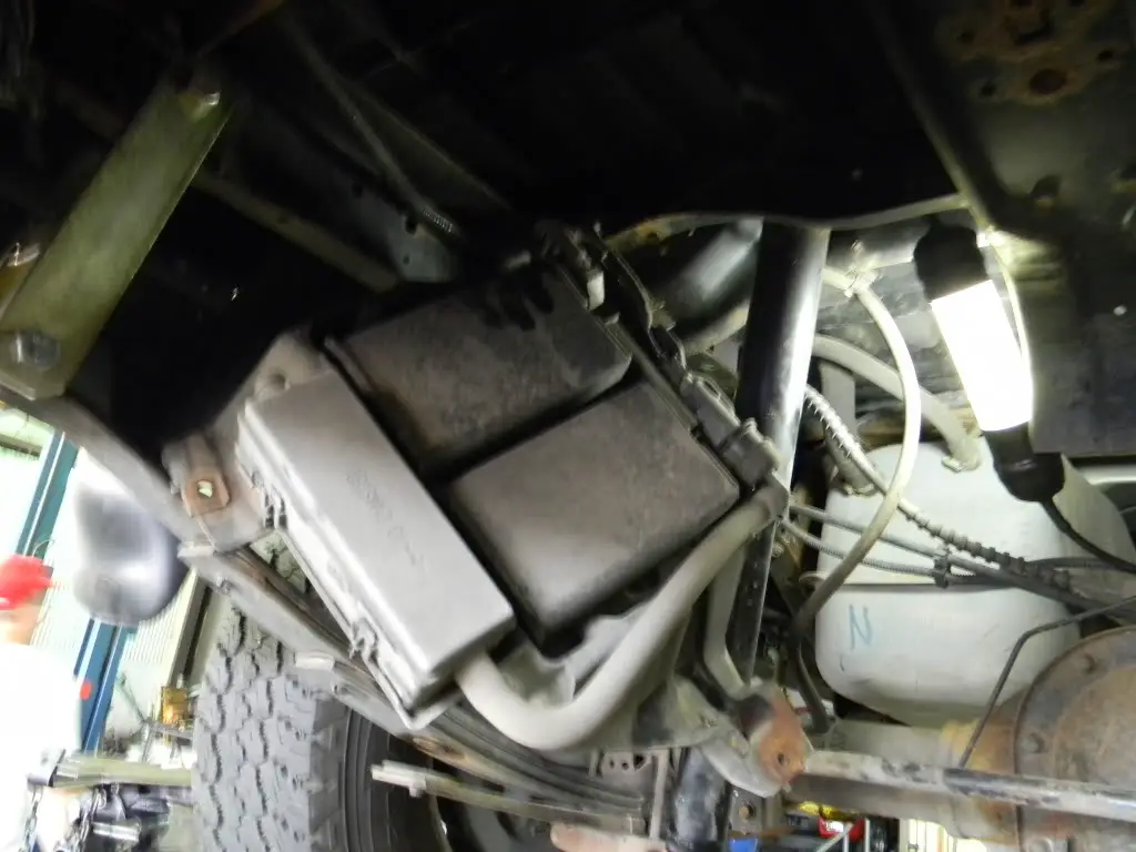

Remove your spare. This is a must! Next loosen your Evap. Canister. This will let you get to the top of the shock.
Loosened Evap. Canister

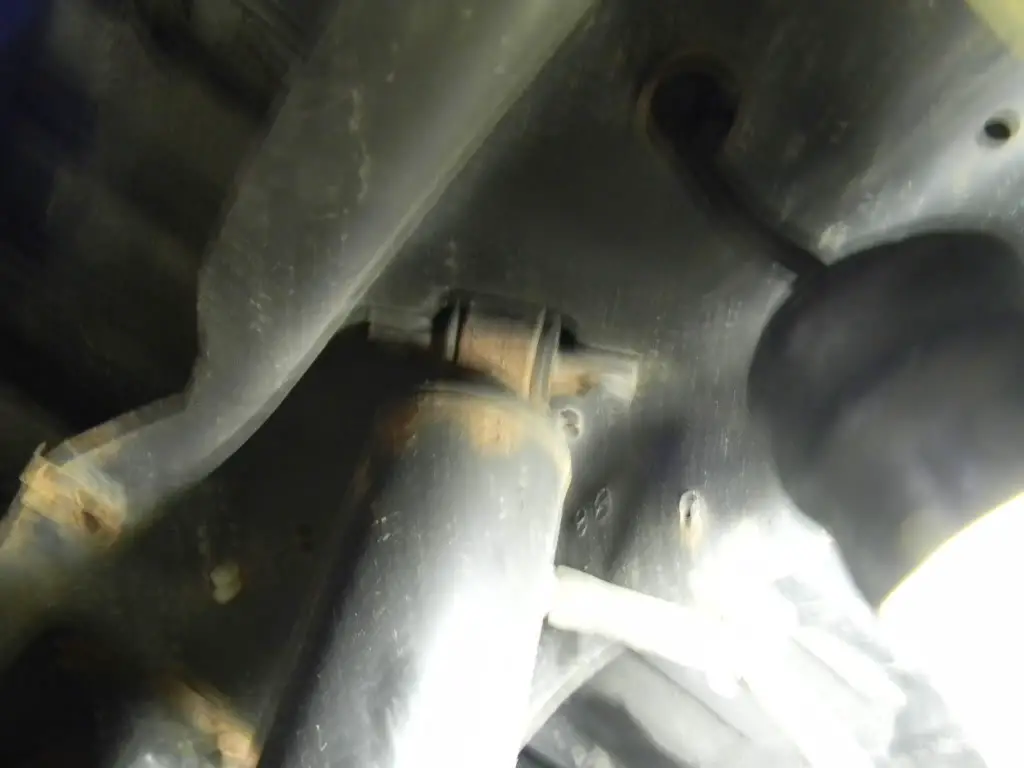

Top of the Shock (sorry it was blurry

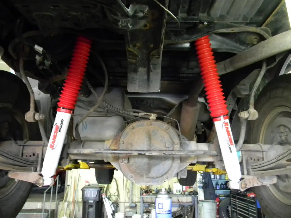

Then unbolt the bottom and throw ur new ones on! Thats pretty self explanatory if you've made it this far.
New Rear Shocks:
New Front Shocks:
