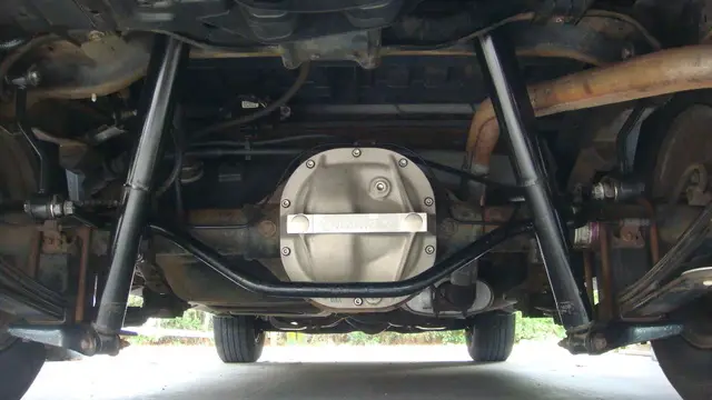

Slightly off topic here. Anyone have an explanation why the sway bar end links and shock mount points are different from side-to-side? Drivers side upper end link mount is at least 1" LOWER than passengers. Any affect on the "Ranger lean"? :scratch:
Drivers side upper end link mount is at least 1" higher than passengers.
Sorry, I meant LOWER. Also note the Addco 633 sway bar drivers side eyelet is bent down and lower.
Still same reason. .I dont fully understand how it works so that why I said ""its been said"" lol I asked this same thing when I was doing a sway bar swap on my ranger.come to find out I had the bar mounted upside down my my explorer.I didnt know they went it a certain way.the explorer and ranger have second gen axle and sway bar swaps.

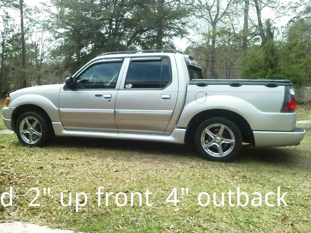

i want a firmer ride,, i've lowered the front 2'' with the torsion twist and blocks in back at 4'' it looks really good ,, level too .. it's my daily driver.. im running 275-40-17's ..
Look into nitro Slammers then.this is who I use and alot of people over on RPS, he is a vendor over there.I just emailed his with my vehicle and drop amount and he sent me shocks.sure he can do same for you:salute:
http://shop.illusivefabrications.com/
O and lets see a picture;)
sorry bout picture size,,
Looks good
