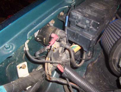

I am no electical genius, but tell me if something is wrong here.
I had the battery out, doing some misc. work, and when I went to hook it back up, I got a spark show and smoke... it was almost a bad scene. Anyway, I immediately disconnected and pulled the batt back out. And I saw this:

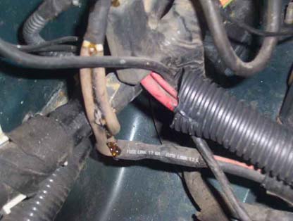

Notice what looks to be chafed wires coming into contact there...
and what is the gooey looking brown substance? Some sort of melted resin?
Anyway my question is, should I wait for it too cool down, then re-wrap (with electrical tape) the chafed wires, then hope for the best, or is there more to it than that. I want to avoid burning up my truck if at all possible...

Damn.. What I'd do is either replace the entire length of wires from the starter relay to the starter or cut them and solder and heatshrink them.
Do you see that in the close-up picture? It looks like those two tan wires were chafed thru...and contacting. I am pretty worried about this.
Replace them, it will only get worse. Once mositure gets in there they are ruined, I had this same problem a few months ago except that every time I hit a bump it would short out and If I wasnt accelerating it would kill the motor too.
I'm more worried about it burning up once I wrap them, and re-connect the batt.
My immediate need is to know if I can simply re-wrap the chafed wires to nurse it along until I can replace.
Ok, I think I have this figured out.
The tan shrink-wrapped wire, is chafed and shorted the h*ll out. That runs to the alternator. As a result, I'm getting no charging from the alt. Bad.
I just hope the shorting didn't damage the alternator or the battery. I guess I'll find out once a new wire is in there.
You can wrap them, just triple check everything and get new cables as soon as possible. If you have a multimeter you can check for any shorts.
It wouldn't hurt the battery or alt. I've grounded out a battery terminal for over a minute before. Got real real real hot in my hand. The pic you showed look like it was no more than 15-20 seconds. No wories mate! Replace and roll!
