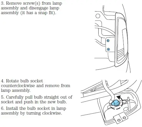

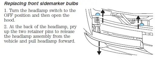

Have purchased front side marker bulbs for my 2006 xl supercab ranger. Had no idea task would be so challenging. Have any of you fine folks any history that can be shared regarding replacing these tiny jewels

Here are the instructions from the 2006 Ranger Owner's Manual. If you don't have an owner's manual, Dead Link Removed.

Many thanks. "Mission Accomplished". Jewels in
