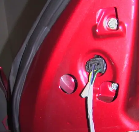

so what abot the wiring, or will it be pretty much obvious what to do when i remove the panel?
pic
It's one plug... three bolts. I have a pic, hold on a second.

sweeet! thanks, now i just need to order it!
