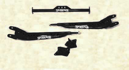

For Reference to those curious what it looks like........
Top piece in the Pic

For those prices I have to wonder if it's JUST the tube only... No radius arm brackets.
Agreed, the tube is a bit thin. I welded another piece of tube inside it (sleeving it) and it was real sturdy after that.
