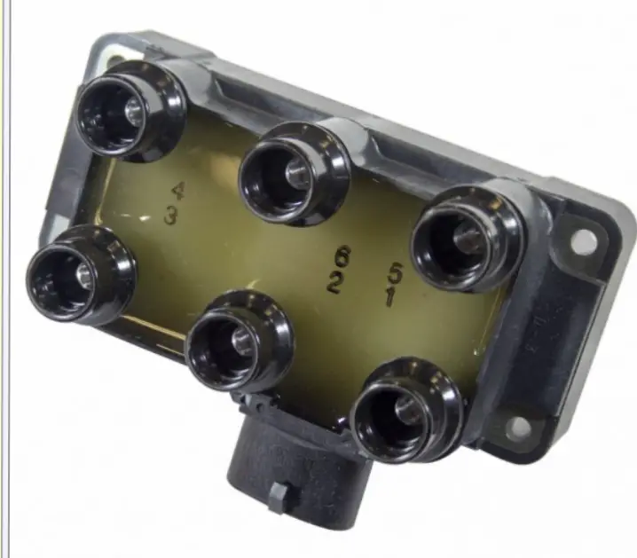

Check your plug wires. It’s super easy to mix up the driver side on the coil. The cylinder numbers are on the coil, but they’re not in order on the driver side.

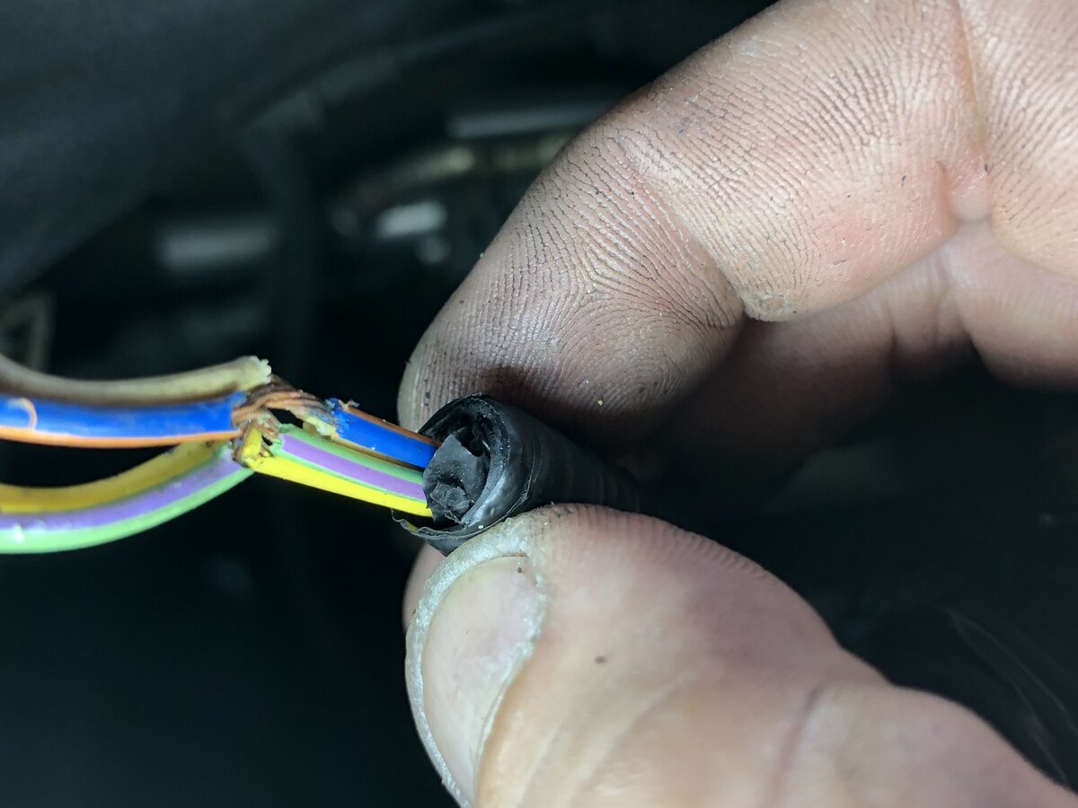

I just had this happen after a tune up the line from the purge valve to the intake, to replace get 36” of 3/8 fuel hose it’s 7 bucks at advance auto, another lesson I learned from gremlins after the tune up was the throttle position connector wires losing their insulation just like the link above
