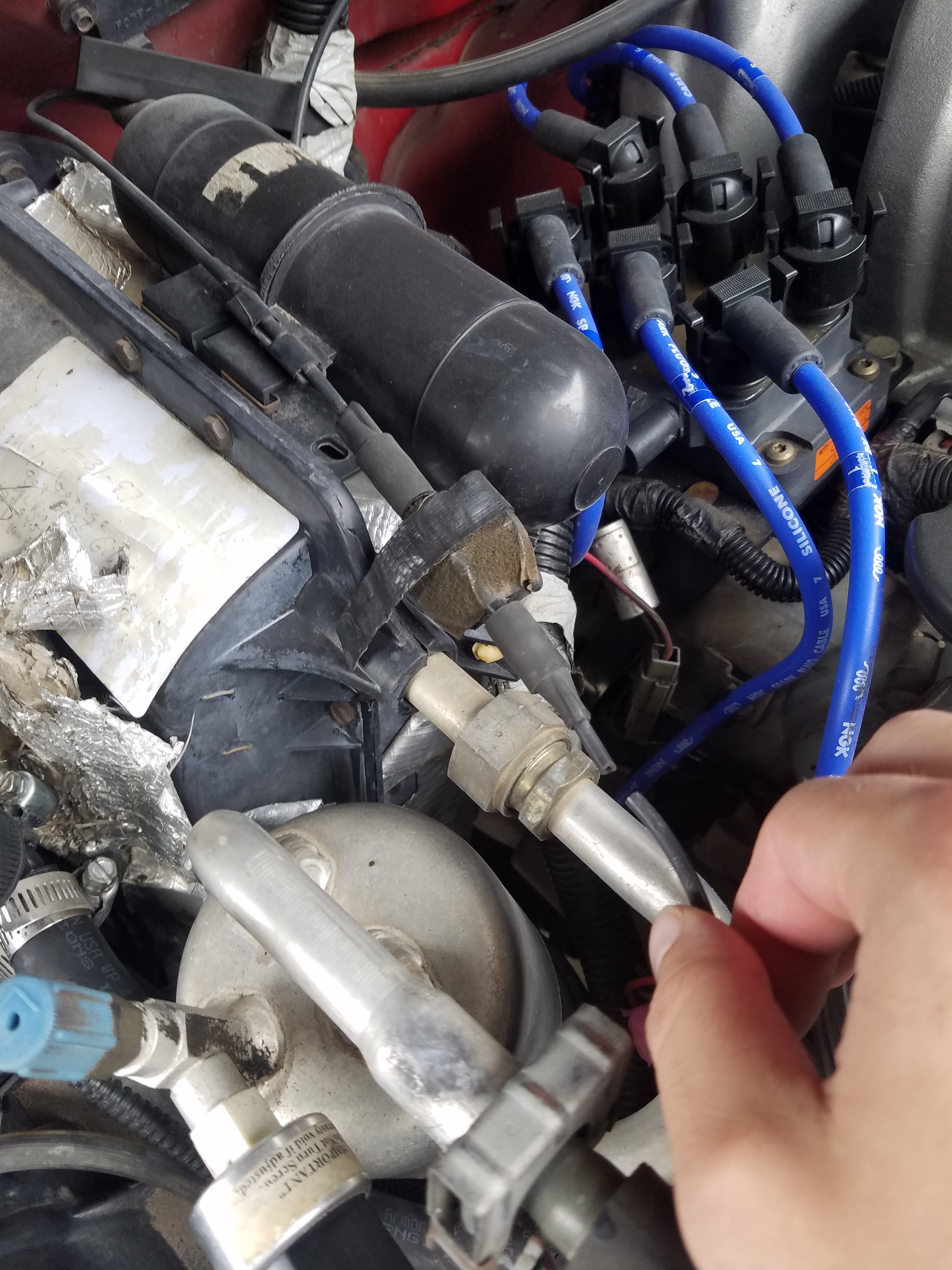

Pics attached.
1. What does this tiny broken vacuum line do other than disintegrate in my hand?

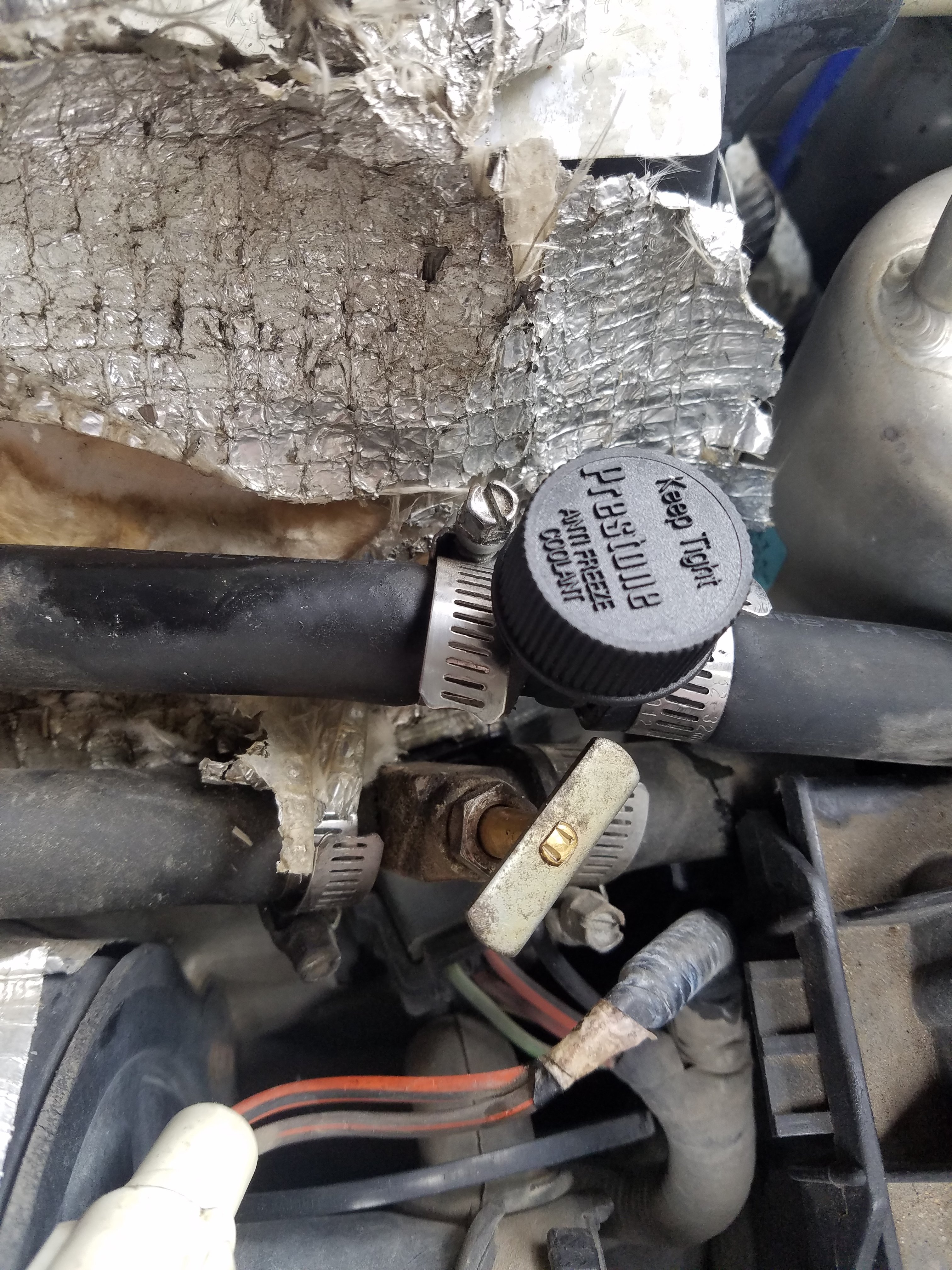

2. Why would one of the POs install these valves on the heater hoses? There was one on each, i just have a coolant flush tee installed in the photo.

Someone has replaced the diverter valve with hand valves, and as you say, you replaced a valve with a flush tee. The vacuum line is part of the system that opens and closes the diverter valve.
So... if you had a diverter valve there, and the A/C was off, the valve would send hot coolant through the heater core. If the A/C was on, The coolant would get to the valve and sent right back to the engine, bypassing the heater core. The idea is to make the A/C colder by keeping the coolant out of the core.
Ok, the vacuum line is from the A/C control panel. If you set A/C or defrost, it operates the diverter valve, bypassing the heater core.
All that said, I'm not a big fan of putting valves there. The engine is designed to have flow through these hoses. If I recall, the supply comes off the water pump, and if it cannot flow through these hoses, that's not good.
What you do from here depends on if your A/C is working, if you want heat at some point, depends on what your goal is for your Explorer.

There are 1st generation Explorers that do not have the diverter valve... Ford added at some point to assist cooling.
With your setup, if the hand valve is open, the heat will work great and the A/C will work ok. With it closed, the heat will not work, and the A/C will work great. I suppose that's why the OE installed valves instead of just splicing the hoses.
BUT... I personally wouldn't run with the valve closed. The engine is designed for coolant to flow through the heater core (or diverter valve if it's installed) and then on to some part of the engine. If the valve is closed, that part of the engine is deprived of coolant flow and that can lead to bad things.
At this point, with the heat and A/C working satisfactorily, you could just splice the vacuum line and forget about it all, or you could install a diverter valve and deal with the vacuum lines. It really depends on where you want to go with this. If it were my daily driver, I'd probably fix it all up. If it were my weekend trash hauler, I'd just run it the way it is. I wouldn't run it with the hand valve closed though, particularly in San Antonio, TX. You need all the engine cooling you can get!
