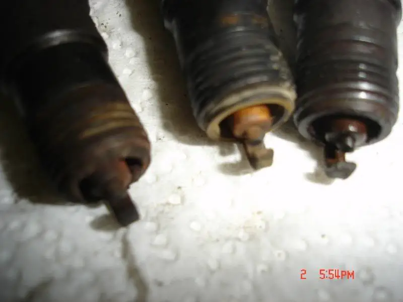

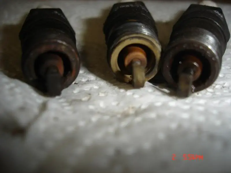

anyhow here are pics of the plugs so u guys can see why the truck barely ran at all.
gotta love the nastyness ... 2 of these felt liek they were rusted in

Looks like normal wear... except for #6 that one looks oil fouled.
Do the full tune up... air filter, belt, fluids, a can of sea foam, and a coat of wax. she'll thank you for it.

okay , everybody missed the obvious ,,
where the heck did the prcelain go from the one electrode ??
hmmmm, i wonder,,
prolly sitting in my cat, anyhow truck runs great i am watching the est mileage and so far im getting around 4-5mpg boost. so far..
