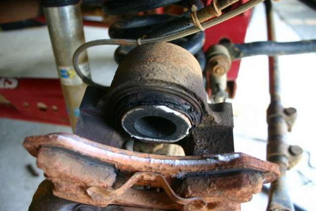

Present day, I finally take everything apart, only to discover the spindle nuts are fine :banghead:, the bearings are fine :banghead:, the caliper piston gasket is roasted and the hub is questionable. I can't find anything apparantly wrong! My only surmization is that somehow it seems the hub wanted to engage going down the highway, but that does not explain the brake failure. I did notice once I got the wheel lifted, when I spun it, there was a ticking noise.
Its weird how all this happened after I got the 35s on. Could the wobbling have anything to do with the wheel problem?
Here's why all my brake fluid decided to quit working. But why?
In these, you can see the little protrusions in the bottom corner of the hub. Each one has a tad bit of its corner sheered off, the reason escapes me :fire:
The more and more I think about it, it appears like I was riding down the highway with the brake pedal pressed. That would explain the caliper roasting, which in turn may have generated enough heat to roast the hub. The grease in everything looks like it has been baked, and since I can't find any metal shavings in there, is it possibile it could just be brake problems?
Sounds like your caliper decided to stick; and is it a coincidence that it happened right after you had the 35's mounted? I would think not...
Did you actually see them mount the 35's? Did they mess with the brakes at all?
I say get all the new parts that you need, put it all back together and See what happens. As far as your hubs go...looks like your gonna have to get some more warns! Either that of put the stock ones back on. I'll come look at it tomorrow before you go to work.

Yes... only the rear brakes are enaged by the E-brake.. It seams from reading your post that the caliper failed which caused it to overheat the rotor, spindle, and hub. How long after getting the tires put on did the grinding start? I would find it unlikely the shop would have screwed up the calipers, (since they shouldn't have even touched them). If they did screw them up then I would expect the calipers to freeze immiedietely and start grinding etc...

It is possible that your caliper was about to go anyway, and it was just a coincidence...
And if it were me I would probably want to replace the bearings, seals, slide pins, in addition to the caliper and pads and hub. And I'd replace the calipers and pads on both sides, too. I'd get that rotor checked with a micro very well...it could be warped from the heat now. And I hope your spindle is ok.

I would think a wobbly rotor which should normally be parallel to the caliper could cause the caliper to get jammed/stuck in its bore which would have cause the overheating.. Obviouslyfinding out why the wheel loosened up and became wobbly is the main concern...
