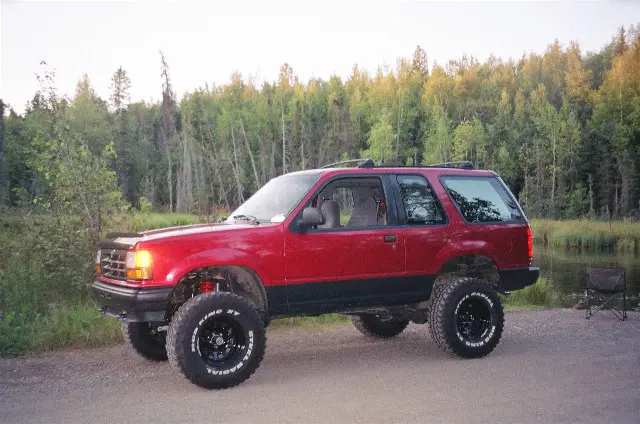

HEY do any of you guys have pics of an ex with soa and 5" coils on 33's i wanna see what my truck will look like
5.5 in front soa in rear with warrior shackles and add a leaf
hope this helps im on 34s instead of 33s but its close

Here is mine when I had the Skyjacker 5.5" and SOA. The tires are 33x12.5 Mud Kings (slightly worn).

Sometimes I wish it were still at that height. My wife could get in and out of it a lot easier. Beleive it or not, I used to tow that camper setting next to it. Now with 35's it doesn't have quite the torque it needs for a good takeoff without straining the clutch. I think 4.88 gears would of been better if I would have known I was eventually going with 35"s. For towing purposes that is!

I have Skyjacker 5.5 front springs with F-150 spacers and rear SOA with Warrior shackels giving 7" suspension lift. I have a 1" body lift on top of that. Theres my 8" lift
so in the picture that I was looking at was 8" of lift, darn, I was hoping that was what mine would look like after 5.5".
Either way yours looks good. Another thing I worry about, is I understand that after too much lift, the angles on your drive train become ockward and you increase you chances of breaking stuff.......have you had this problem?
No problems yet. I did have to have my rear driveshaft lengthened about 3" since mine is a 2 door. With a SOA you set the angle when you weld the perches on. Mine was actually off a bit. Installed a 4 degree shim and fixed that.
