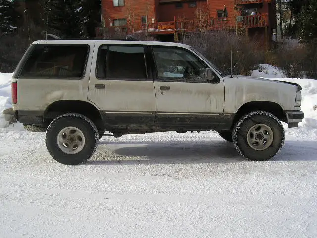

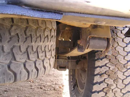

Wisekise, I actually did a monoleaf soa about 5 years ago on a 94 explorer I had. I recieved about 3" of lift from this. The monoleaf was completely flat when the weight of the vehicle was on leaf springs and the truck was "wavy" in the turns if I remember correctly. I have pictures of my 94 in this thread, Click on this.

Problems were: flex wasn't all that great, being I only had one leaf, and it was a little wavy side to side on the highway through turns. Other than that, I really liked the ride it had with the softer 2 door monoleaf. Also, I had an soa with 3 leaves in the four door pack and it was still around 4-5" of lift which was too much lift for the rear for me, That's why I went with a monoleaf.

You are correct, 1st gens four doors did not come with a monoleaf. It was an experimental setup for something to try. I got the monoleaf for free from someone on the site.
