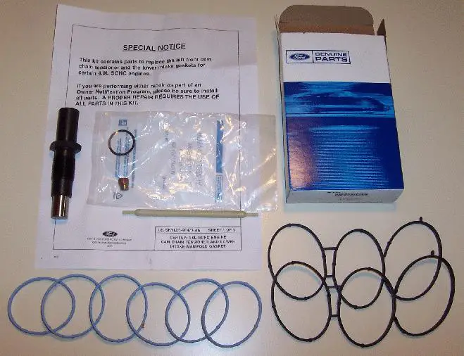

I removed the oil galley plug and attempted to spray WD40 as deep as I could, but the passage was blocked by what appears to be one of the oil passage restrictors from Ford. I did NOT install this when I replaced the chains and tensioners.
So can anyone think of a way to remove this restrictor without pulling the head and turning the thing upside down? :D I suspect sludge has built up behind it and was preventing pressure from reaching the tensioner.
reducer not restrictor
The oil restrictor is actually a galley chamber volume reducer. It's purpose is to decrease "dry start" time so the tensioner gets oil pressure sooner. It was included in the 00M12 kit.

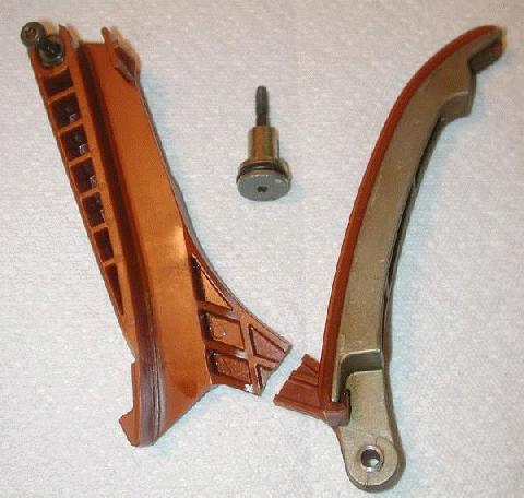

Did you inspect the rear cassette guide when you had the engine out and the upper intake manifold off? See Timing chain rattle resolution process - SOHC V6

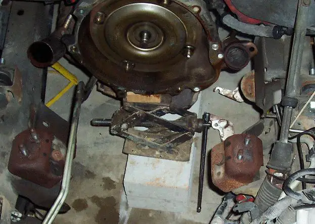

So I got to thinking. When I pulled the engine, I left the torque converter bolted to the flywheel and pulled it with. Obviously, some fluid escaped. Well after checking I discovered that it was...about 5 qts low. :eek: Good thing I haven't tried to drive it. I filled it back up, but this didn't seem to help the noise.

pulling engine with torque converter

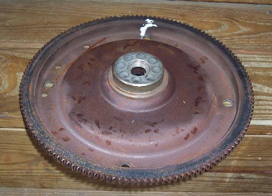

The only time the engine should be pulled with the torque converter attached is when the crankshaft can't be rotated to loosen the nuts. Leaving the converter in place increases the risk of damaging the transmission front seal. However, even if the seal is damaged it should only result in a leak and not a loud noise. Did you forget to install the spacer or install it on the wrong side?
The spacer should be installed between the flexplate and the crankshaft. It is possible to install the flexplate without the spacer installed. The result would be that the ring gear is forward of the normal position and the starter gear may not fully disengage the ring gear.
It may be possible to assemble the engine to the transmission with the spacer on the transmission side of the flexplate instead of the engine side. It depends on the length of the torque converter to flexplate bolts. The flexplate is not very thick and would distort toward the torque converter when the torque converter to flexplate nuts were tightened.
Thanks, I'm planning on pulling the starter tomorrow and double checking the flexplate and torque converter. I remember putting it all back together, and I'm pretty sure I had the spacer and flexplate the correct way around.

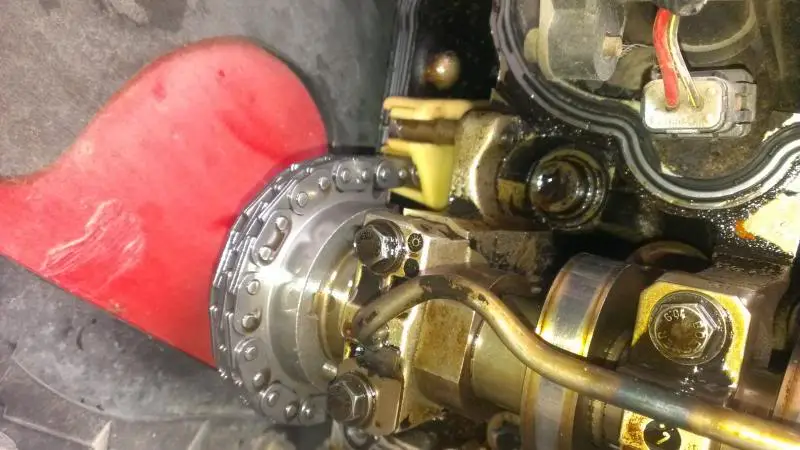

Here's the rear cassette.
pull guide upward
I suggest that you grab the top of the guide and pull upward. It should not move more than 1/16". The guide can break near the bottom and look OK at the top.
Also, reach down beside it with your fingers or a flat blade screwdriver and see if you can deflect it sideways.
Just went out for the day and that was the first thing I checked, and it all seems perfectly fine. No up and down or side to side movement, it's rock solid. I also cranked the motor over with the valve cover off and there was no movement down around the guide, so all seems well there.
