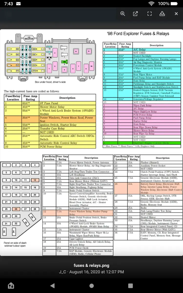

First check the fuse, there is one near the door hinges and that protects power windows, domes, and 4x4 clutch. Also there are a plethora of hidden relay boxes in an Explorer, above the throttle pedal those in there will also do what you describe.
For checking wiring I highly recommend a Ford manual. The troubleshooting is methodical and effective without the stress of trying to conjur up black magic or guess work, trial and error, etc.

You should check out the relay situation...I'm dealing with one RIGHT NOW exactly same symptoms.
I don't have my book in front of me, but I for some reason am thinking power saver relay...near the throttle pedal.
Do you have the same issue with the door ajar inconsistency / key jiggling in the ignition causing it to start the bonger again, only for it to cut off before finishing?
I've gone ahead and ordered a couple of relays. Both from Standard Motor Products.
- RY116 for accessory delay / power windows
- RY612 for battery saver
No idea if they will help but they are only $10 each so would rather try those first before fussing around in the door hinge...
Will update here whatever I find.

Anyway, I haven't worked on this one here yet, but what I know is the power saver works, but won't turn back on normally. So far all I've done is jiggle relays, which has reset the power.
