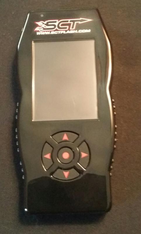

So went and filled up with some 93 and installed the 93 tune in the box from SCT and immediately noticed some pinging. So pulled over and backed off to the 91 octane tune and the pinging stopped. I think this was probably due to there still being a few gallons of 87 in the line and tank - so better safe than sorry.
During that tank of gas (on a road trip) saw close to 400 miles on one tank. During the few times that I did get on it - there seemed to be a bit of SOTP increased power - but not as much as when I did the airbox mod.
Next tank of gas (after it ran down to practically empty) went back to the 93 tune and pinging was gone. A bit more SOTP improvement was observed.
Now waiting on Henson's tune to see how that goes.

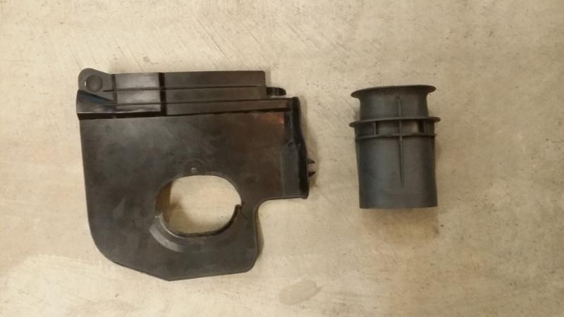

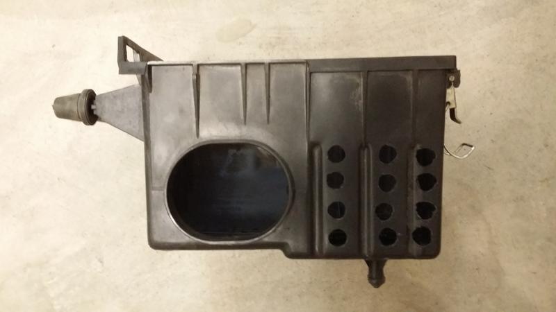

It may have changed throttle response a bit, but it appears you now have a hot air intake pulling-in engine bay heat?
The stock air box is a good cool air intake design. I opened-up the front hole in the airbox, installed a large tube to reach out in front of the engine compartment and grab the cooler air. Then I insulated the air box from the engine bay heat.
Go man and enjoy. I am going to put a vacuum nipple on my air box and connect a vacuum gauge. I want to make sure there is no vacuum in the box at WOT.
