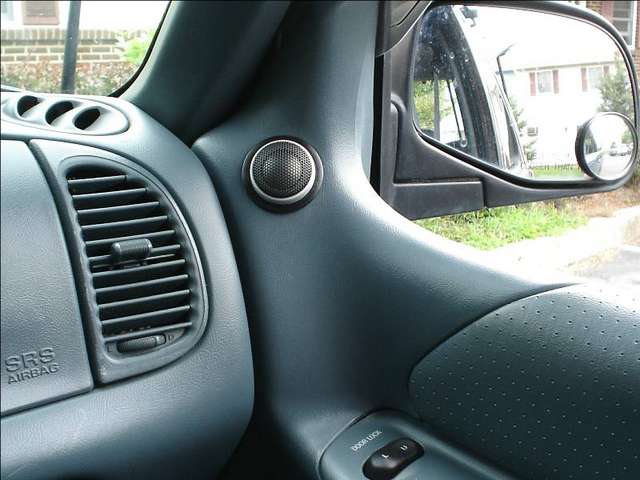

And where is the best place to install a set of tweeters, I was thinking

OK cool that's what i wanted to know, but what about tweeters, I really want to put them as shown in the pic
that works for me,, i just happen to have a set of Lanzar titaniums sitting around , might do that myself,,
so i guees thats a yes to the tweeter location cool, now if only my X wasn't like 200 miles away so i could at least install what i have for it
yeah thats a sweet place to put them, and no sony doesnt suck!!

no no no, I am buying tweeters separate

i have 2 way speakers in each door, plus 4 tweeters mounted somewhat like that picture, the tweeters make a night and day difference, just make sure your using some kind of HPF, or cross over, you dont want the lows getting to them.
Nix that doesnt work well. You will need a crossover for that setup it will sound like crap. Those speakers are not made to be used with a seperate set of tweeters. This will sound like crap. Save your money - do some research anddo it right the first time. Take my word for it - just do yourself a favor and spend a couple weeks researching this before you make your decision.
DONT BUY THOSE SPEAKER AND TRY TO ADD TWEETERS, YOU WILL BLOW THE TWEETERS BECAUSE YOU NEED A CROSSOVER AND THEY DONT COME WITH ONE. THEY ARE NOT MEANT TO BE USED THAT WAY!!!!
