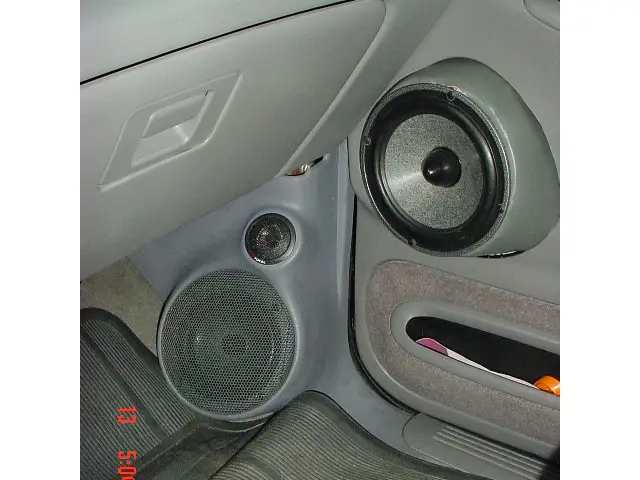

Passenger's Door Panel after some light glas work and sanding.
Driver's Door Panel after some light glas work and sanding.
Radio Bezel with an Alpine ERA-G320 EQ already custom installed.
More work done now. Getting redy to begin an installation.

Ahh, lots of door questions. Well I wanted a custom fit with the Boston Z6's and not just a hole in the door. The main doors were matted for accoustics of course. Also there are the beautiful Boston cross-overs that I hope to show. But we will see. They are to work on removing the "humps" out of the doors, tht is the part that catches all the trash, umbrellas, and anything else you can think of that may slide in there, especially dead bugs. LOL.

BTW, I dynamatted my doors and put mid-drivers in the stock locations, but everything in there rattles like hell now. So make sure the speakers (whatever's in that area) gets a small pod so the sound doesn't resonate throughout the entire door and all the innards. (sounds like crap)

That is one of the reasons for the door build up with fiberglas. I also bought a pair of those kick panels from ExplorerExpress because I was going with 3 540 amps, and 3 pairs of Boston Z6's, but the tweeters would not fit. So I had to cut the 3rd pair of Z6's out and return them. I did not have the amp yet. But I am still tossing around the aspect of putting in a 3rd sub mounted in the rear with the other 2 along with another MRD-500 mono amp. The HU, an Alpine 7998 has this digital timing stuff that yall are talking about. It has 6-channel ditial time correction, 6-position 12db/octave crossover, subwoofer level control with phase selector, 5 band parametric EQ, 4 volt subwoofer preout, 3 preouts, and plays all cd's. So I got some bang for my buck on that one for sure. Another feature that I like is that I can program it with a disk from my computer so I once I find the correct settings, I can burn a disk and never loose them again.
