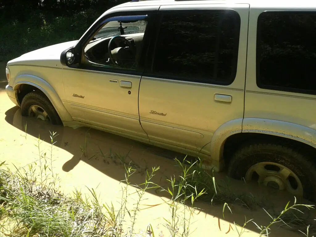

I took my car through a puddle yesterday and ended up stuck int he water for an hour until my uncle pulled me out with his dodge
After I got out I had my ABS light on, I restarted the car and later saw I have code C1233 (It took me some time to notice because I have 2 other codes right now) Could you guys tell me how I can replace the sensor that goes with this code?
C1233 is left front wheel speed sensor signal missing. Clean mud off, follow the wire from it, check if the connector is corroded. If all else fails, replace it.
