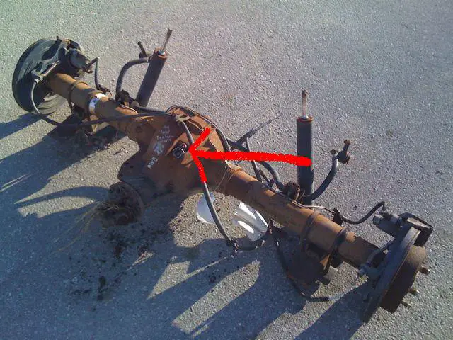

The speedometer on my 99 explorer wont work.
Can I check the vss and where is it?
vss is in the rear differential, , on the top of the center section, or pumpkin,, with the 2 wire connector to it
