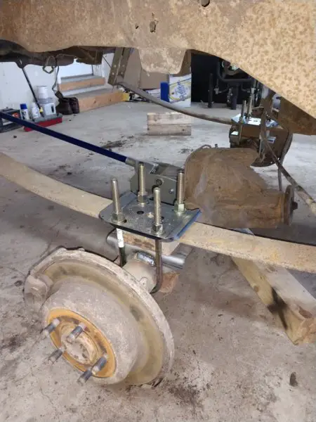

Does anyone know where I can purchase one of those Spring Over Axel kits. The one with the brackets that sit on top and use the old bottom brackets for placement and support. I have seem pictures but the Supplier (Summit Racing) no longer has them. I have a 98 4dr with 4.0, 4X4, 3.55 non LS Thx
You buy a set of spring perches and weld them to your axle.
There are many threads, including mine below that detail this process. Lots of good information and lots of work. Takes more than a set of spring perches to put an axle under it.
Happy Hunting!
Barnes4wd.com has spring perches just make sure you get the 3" diameter ones for the 8.8 and then you'll need to weld on new shock mounts on top of axle and the u-bolt plates roughly 100$ and it'll be done

Because at the time I was doing it on a budget, even tho these springs are a little sketchy they flex well but I'm still debating on doing a linked rear but if I don't do links I'd like to change to a normal leaf pack

Oh ok, yea this is just an off-road only rig so it's pretty light. I have put full widths axles on now and chopped the back half off and cage since this picture

Well before I did anything I took the stock pinion angle with my angle finder and then did the same angle with my perches as zero, I can't remember exactly but I think it was around a 7 degree upward angle and for my shock tabs I bought some from barnes4wd.com (part#B4W25002BP). I welded them on top. I'll take a pic later for you when I get home
